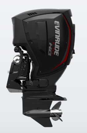

The deal for repowering a new Boston Whaler 210 MONTAUK with a Mercury OptiMax 200 engine fell through. I went down the path of doing this with a G1 E-TEC. In the end, after much deliberation, I decided to go with a G2 E-TEC 200 H.O.
I have purchased the boat and paid for the upgrade on the engine. This will take a bit to get the engine ordered and to get rigged up, but here is the boat and the color combination on the G2 I decided to go with:

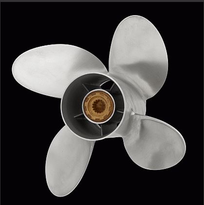

I am very excited to see how this boat/motor combination will run. Propeller selection might be a bit of a challenge. I was going to go with the new Evinrude RX4 propeller, but after some researching and talking to BRP, one of the strengths of this propeller is that "it delivers superior bow lift'.
In the past I have not had very good results with bow lifting propellers on 170 Montauk boats. In my experience they raise the lifting strakes out of the water and the rounded stern becomes the only running surface, making the boat squirrel-ly and prone to proposing.
On my 170 Montauk with the E-TEC 115HO I have had very good results with the Power Tech SCD-4 a stern lifting semi-cleaver propeller. Since I might be the first one putting a G2 200HO on a 210 Montauk there isn't really much of a point of reference. The closest would be the performance reports from Boston Whaler with the 210 Montauk rigged with the Mercury super charged 200HP L-6 Verado (almost 100-lbs heavier); the factory uses a Mercury 14 7/8" x 16" Enertia propeller - which after some research seems to be a fairly neutral lift propeller.
I spent some time on the phone with Power Tech and with all the torque the 3.4L G2 block produces they recommend starting with a 14-1/4 x17 SFS4 propeller. The technician mentioned that the SFS4 propeller (see below) has moderate rake, good blade area and is a slight stern lifting propeller. Comments are very much welcome.

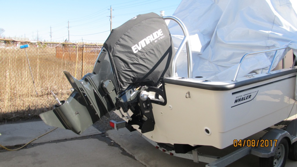

Here is the first picture of the Evinrude 200HO G2 mounted on the 210 Montauk:

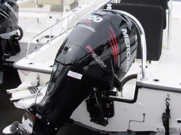

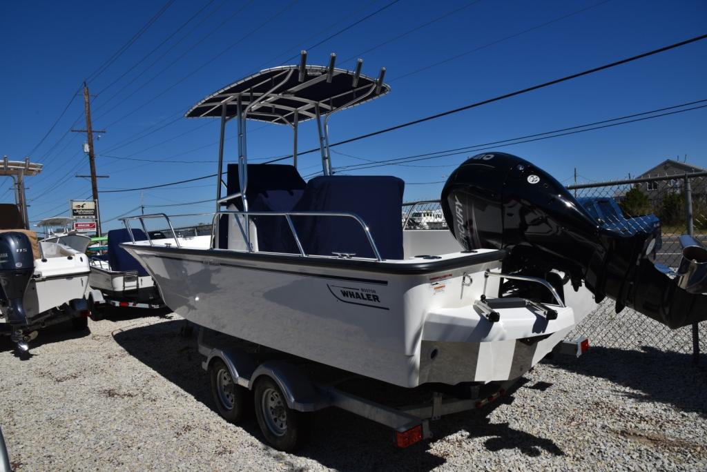

It's hard to tell if the lower unit will be clear of the water, as the tow arch is blocking full tilt of the outboard. A factory rigged 210 Montauk with a Mercury Verado 200 XL L6 also has the same concern:

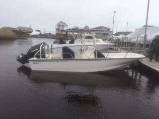

Postby Ridge Runner » Wed Apr 19, 2017 3:01 am
The lower unit of the outboard just clears the water:
The Evinrude 200 H.O. G2 weights 80 pounds more than the standard Mercury 150 FourStroke and 98 pounds less than the optional Mercury 200 Verado Pro FourStroke L6.
