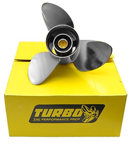

Another option would be to try the Turbo Quest. It is supposedly made specifically for the F70. I have not tried it, but it looks to have the same characteristics as the SCD-3, with a more rounded style on the leading edge.

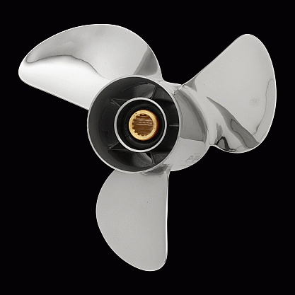

Does anyone have a picture of the Yamaha Performance Series prop? I would be interested in how it compares, in terms of blade area, rake, and cup to the Stiletto Advantage 1 that I found to perform poorly on my boat, and the SCD-3 which was a vast improvement.
I understand that the SCD-3 is very similar to the Yamaha Painted Stainless prop, just not painted (d'oh) and available in 1" pitch increments.

Postby Phil T » Mon Nov 21, 2016 3:13 pm

Thanks Phil - I did see those photos, but because the angle is so different from the ones I posted, it is hard to compare.
