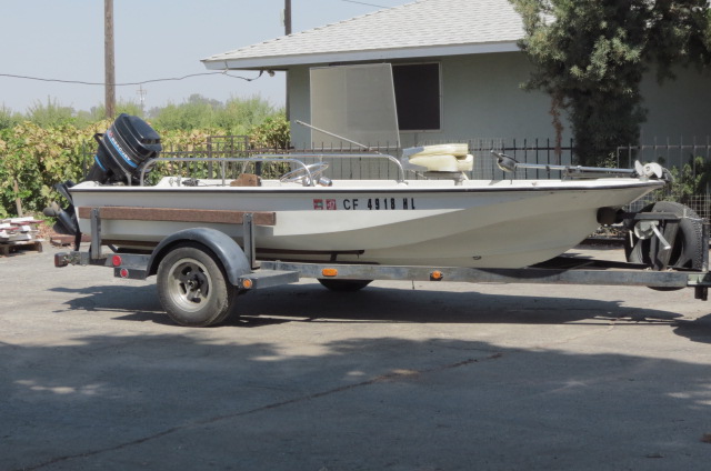

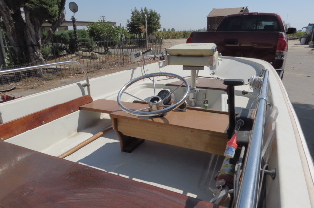

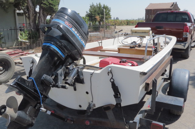

Thank you to all for the feedback- it appears a number of options are in reach based on the information.
Jim, from what I gather from the owner, it is a 4 cylinder with power tilt and trim. He is the second owner of the hull and motor since 1985. He states there are few hours on the rig, although that can't be confirmed.
Gas prices in CA are steady at $3 per gallon, regardless, it is a big decision to spend that kind of money on a newer motor. Your comment on the reliability of the motor is heartening. My major concern is the fear of a breakdown somewhere on the water. From what you say it appears that I may be in good shape here. A secondary concern is range, I will be keeping 6-10 gallons of gas and the fuel comsumption "should be" somewhere around 5 gallons/hour for an older 50 hp such as this Mercury motor.
I'd love to keep it all original if possible it looks great as it is sits

The engine in your pictures looks like the classic four-cylinder 44-cubic-inch engine I had. The only problem I had with that engine was the carburetor float valves would stick. I had the carburetors disassembled and cleaned, and it ran very well after that. I sold it many years ago, but the I am still in contact with the buyer. That engine continues to run very well for him. It was a a 1976, so even older than the 1983 you might buy. Here is my old boat

Jim--my primary consideration is not fuel economy, it is essentially two factors.
1. The primary concern is reliability- the areas I will fish, (the California delta), is comprised of hundreds of miles of waterways, estuaries.sloughs, and river. There are a number of locations where cell phone coverage is non-existent, and vhf radio range is limited. In the case of a breakdown, it is quite possible I will be waiting for a long time for another boater to pass by.
2. A secondary consideration are the restrictions placed on 2 stroke motors in California. There are a number of waterways that prohibit two stroke motors compeletely, including 3 star rated ETEC models. [This topic has been separated from this discussion into a separate thread.--jimh]
With that said- I did place an order today for a new stator, trigger and wiring harness assemblies, new trim and tilt hose assemblies, and steering cable. The total cost is well under 700 dollars, a pleasant surprise frankly.
Given your positive comments regarding this model of motor, which I have buttressed with a number of my own inquiries, I have decided to stay with this engine, after updating all the suspect electrical connections.
The motor itself is in excellent shape and shows no sign of major work ever being performed.
If it fails, I will cross that road at that time. Until then I am going to keep the rig the way it came from day one- I like the look!
