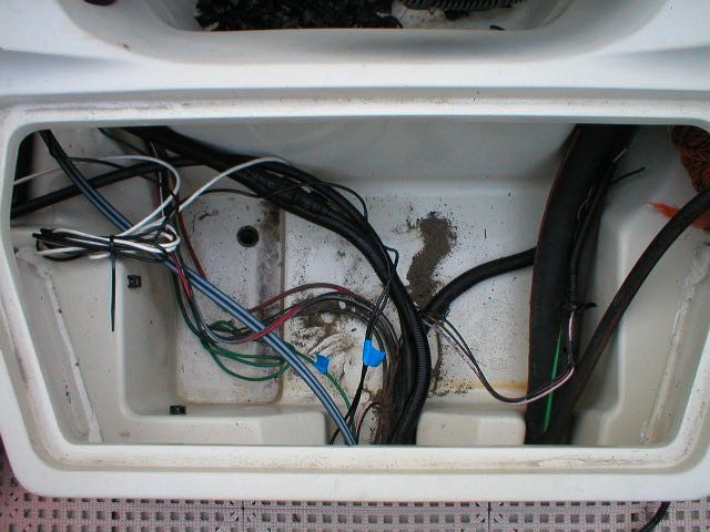

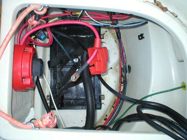

Before I moved the battery. Note the cuved channel on the right side. The drain is at 3 oclock. Note the drain continues down to bottom of photo.
Water from the floor will come into the bilge in the upper left and upper right from the floor channels and fill the very large recessed bilge. Note there are two openings at the bottom that goes to the fuel cavity. When you pull the plug, the water will fill up this entire area, into the tank cavity and up to the floor all the way to the console.
To combat all the water I shipped when backing into waves that filled and overflowed the splashwell and filled the bilge, I installed a 1200 gal/min pump and smooth sided 1 1/4" bilge hose
This is a very different drain/bilge setup than any other model I have seen.

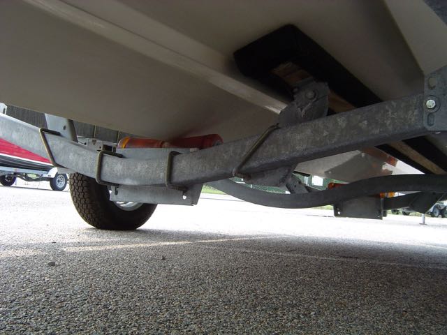

The hull shape of the 1990-1995 Outrage 17 is nothing like the Montauk, rather it is similar to the Outrage 18.
Here are a few photos:
From the rear:
Looking aft from forward of the console:
Re: 1991 Outrage 17 Stern Waterline
