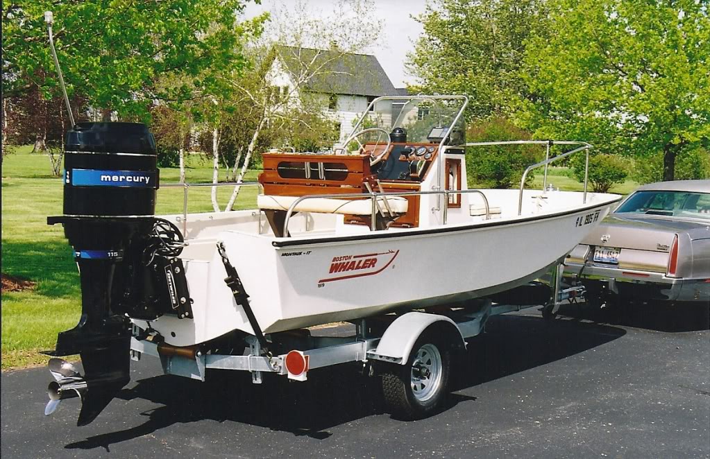

The boat image in Phil's post is not Phil's boat. Based on the Illinois registration and the 25-year-old Cadillac sedan towing it, the boat must be Larry's.
Unless your goal is to get the maximum possible boat speed under the calmest sea state with the lightest possible load, choosing a LASER 22-pitch will probably not be the best all-round propeller. Your intention to try a 19-pitch is probably a good choice.
