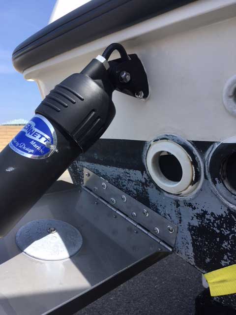

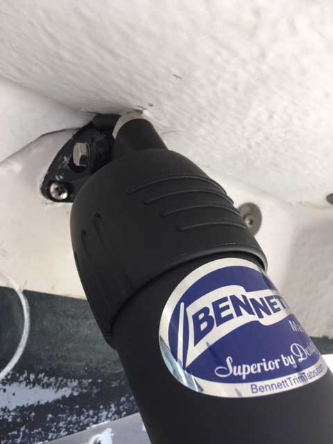

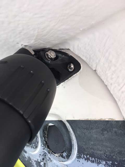

FOLLOW UP: I installed Bennett Bolts Model 9 x 12 Edge-mount trim tabs. I didn't want to deal with hydraulic lines. I installed the simple rocker-style helm control (not shown).
Fig. 1
Fig. 2
Fig. 3
As you can see from the starboard swim step pictures, I used a small rotary tool and created more recess to accommodate the tabs. All said and done, I achieved a 3/8-inch negative articulation, not the 5/8-inch recommended by Bennett.
This past weekend took the Outrage offshore for a 130-mile round trip and tested in all conditions: up=swell, quartering-swell and wind waves, and a down-swell run home. I am pleased with the results. My main concern was the down-swell performance since I didn't have the 5/8-inch clearance. There were no problem, as with tabs fully retracted the boat ran well without lowering the bow.
I now am able to trim the Optimax 225 engine in a more optimal running position. Before tab installation, I had to trim the engine fully down (tucked in) to get the bow down somewhat, but not down far enough when running uphill and could not correct for list. Now I have improved feel and smoother ride. I have no pre-tab and post-tab efficiency numbers. But running home at4000-RPM at 32 to 34-MPH I was averaging between 2.2 to 2.3-MPG according to the Smartcraft gauge, and the engine was trimmed level.
I am satisfied with the initial results.

Thank you for the follow up report and the illustrations.
I re-oriented your images so they would appear correctly as in-line elements, added them to your initial reply, and gave them identifying captions.
I believe Fig.1 and Fig 2. show the starboard side installation of the actuator mounting under the swim platform.

Steve, in your photos I cannot tell if you used edge mount tabs versus conventional tabs. Can you enlighten us before I proceed further?
zigzag930
Posts: 83
Joined: Thu Nov 08, 2018 2:04 pm
Re: 210 Outrage Trim Tab: Recommendation; Installation
Postby zigzag930 » Wed Feb 27, 2019 4:04 pm
He used the edge mount tabs. If you go back you'll see where he identifies them and can also tell by the pictures.
Looks like a tight fit on the side with the boarding platform and slight modifications (dremel work) to get it tucked in under the platform.
