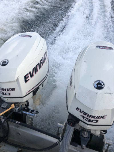

I'm still trying to help my friend with his Guardian 25 with twin 2008 E-TEC 130-HP engines. We use it as a rescue boat and it sees little use.
The boat has a jack plate so no "holes up" reference point. I was out in it today, the outboards run deep, on plane you can't see any of the anti-[ventilation] plate, and what I think is called square "mount bracket cover" is barely out of the water and that is a good 6-8 inches above the anti-[ventilation] plate. This is at a GPS speed of 30-nautical-miles-per-hour on plane and the engines are running at about 4,700-RPM. The starboard engine had an problem and would only rev to 4,700; the port engine would run up to 5,500. There is a lot of spray off the outboards as well.

Fig. 1. View of engine mounts at speed
Cf.: http://pic20.picturetrail.com/VOL164/20 ... 036639.jpg

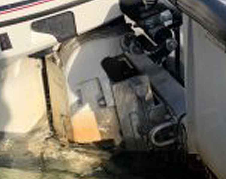

Fig. 1. Close-up from original image. The mounting bolt looks like it is in the three-holes-up from lowest position.
The image posted above appears to show the engines are attached to the jack plate with three-holes up position. That will add a lift of about 2.25-inches. Despite that lift, the engines look like there are very deeply mounted. They're really low and deep in the water. Judging by how deeply the transom is notched, the hull may be intended for 20-inch shaft engines for twins.
Get the Evinrude complete model number on the label on the mounting bracket. That will define the shaft length, assuming no one modified them.
If the engines are 25-inch shaft, then they need to be raised about 5-inches just to get to "lowest" position. To go two-holes-up from there will mean 6.5-inches of lift to compensate for the wrong shaft length.
For a 25-foot boat with such a heavy load, the twin 130-HP engine are really being taxed to push that boat around. And even heavier loads if the boat has to tow another boat home for a long distance.
