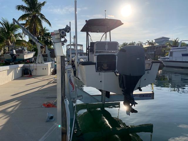

Fig. 4. Stern view
21 Boston Whaler stern 4.jpg (49.25 KiB) Viewed 12391 times
