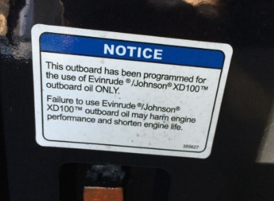

As an update, I did not end up purchasing the dealer-demo engine that prompted me to begin this thread. I was not able to find a purchaser for my Yamaha in time to make that deal go through.
However, I continue to consider the E-TEC 135 H.O. engine as a possible option for repowering.
Because the subject of reduced oiling came up earlier in this thread, I wanted to provide some additional information. In my on-going research, I have learned that the 135 H.O. and 150 H.O. E-TEC engines do not offer the reduced oiling setting. Instead, they are set at the factory for the TCW3 setting, with no factory option to change the setting. Additionally, these engines require use of the XD100 oil, even though they are operating in the TCW3 oiling mode.
This is different from the standard E-TEC 150 engine, which DOES have a reduced oiling option as well as the option to use TCW3 oil in TCW3 mode.
Peter wrote:The 135 H.O. can be set to use the reduced oil rate setting just like the 150.
Re: Evinrude E-TEC 135 H.O. Re-power for Outrage 18/19
JRP wrote:...I have learned that the 135 H.O. and 150 H.O. E-TEC engines do not offer the reduced oiling setting. Instead, they are set at the factory for the TCW3 setting, with no factory option to change the setting. Additionally, these engines require use of the XD100 oil, even though they are operating in the TCW3 oiling mode.
Wow--that is very unusual. I never heard of any E-TEC engine being limited to only using the XD100 oil all operating condition. What was the source for that information?
I do not believe what you've been told. I think it is wrong.
If Evinrude (or any manufacturer) sells a product and tells the consumer that the product requires only a certain brand of accessory in order to operate, then the manufacturer would have to supply that accessory with the product. In other words, if Evinrude sold an outboard that they said can only be operated on the Evinrude XD100 oil, then Evinrude would have to supply that oil to the customer. This comes from the notion of a prohibition of mandatory tie-in sales as regulated by the FTC.
Evinrude does highly recommend use of their XD100 oil in all the E-TEC engines, but, as far as I know--and according to my very well-informed dealer--there is no E-TEC that must only use XD100.
There is a lot of confusion about this topic. The confusion originates because if the consumer chooses to select the reduced oiling feature, then only XD100 can be used.
Also, on many models designated H.O. there is no option to use reduced oiling. This is because the notion of being a high-output engine carries the inference that the engine is going to be operated at high throttle settings most of the time. For that reason, the option of reduced oiling is not available on those models. But, again, I never heard of any E-TEC that requires it must always be run on XD100. That is my understanding, based on my dealer's understanding--and he is really an expert on this.

jimh wrote:What was the source for that information?
The initial source for the lack of a reduced oiling setting on the 135HO and 150HO engines was an Evinrude tech-rep at their facility in Wisconsin. This particular factory tech-rep happened to own a 135HO and operates it on his personal boat. So he was very familiar with the engine.
In subsequent conversations with two different local Evinrude dealers, I was also apprised of the factory requirement to use XD100 oil at all times with these two engine models (135HO and 150HO), even though they are operating in TCW3 oiling mode. I suppose both these dealers could be mistaken, but it seems unlikely since they were each seperately definitive on the question.
From my personal vantage, I would be pleased to learn that the information concerning the requirement to use XD100 oil in the 135HO engine is mistaken. I do no mind the lack of an XD100 reduced oiling setting, but a requirement to nevertheless use the XD100 oil is irksome.
Perhaps Evinrude only requires use of "XD100 or equivalent"? If there is an aftermarket alternative to XD100, then that would certainly get Evinrude off the hook with respect to the FTC proscription. Even if there isn't an equivalent available as yet, they may be able to skirt the law by allowing use of an equivalent should one be available.
Given the uncertainty that the FTC restriction suggests, I will contact the factory tech-rep again and seek clarification.
However, the more important piece of information here is that there is no factory option for an XD100 reduced-oiling setting for the 135HO engine I am considering as a repower option. I hope this is useful information to others considering this engine for their boat.
Friends, the attached picture is a sticker on my console door...put there when I took delivery of my new 2015 150 HO ETEC (18 Guardian). Dealer told me that is what he programmed the motor to run on...told me not to use anything else unless it was reprogrammed. As I wrote above, I'm really pleased with the performance in all respects.
- image.jpg (36.88 KiB) Viewed 69299 times
Maverick wrote:Friends, the attached picture is a sticker on my console door...put there when I took delivery of my new 2015 150 HO ETEC (18 Guardian). Dealer told me that is what he programmed the motor to run on...told me not to use anything else unless it was reprogrammed. As I wrote above, I'm really pleased with the performance in all respects.
Mav, very interesting!
Of course, more definitive confirmation will come when you have an "Engine History Report" generated next time you have the engine in for service. There is a field on the report which indicates the oil ratio to which the EMM has been programmed. If it has been re-programmed to reduced oiling, then that field should indicate "XD100."
Given what I have been told by the Evinrude tech rep with whom I spoke, my only real concern would be that the dealer may have installed a patch that is not factory authorized for an ETEC 150HO engine and could be a problem for warranty. To allay any concerns, you might inquire with Evinrude customer service, and ask to speak with a tech rep familiar with your engine model. If you do, please report back on what you learn and maybe we can resolve the inconsistent info coming from Evinrude (dealers, factory) concerning reduced oiling and the 135HO/150HO engines.
Well, I don't ever plan to use anything but XD-100, so shouldn't be a problem. I was able to pick up a few extra gallons of it at a good deal with a special Evinrude sale coupon, so I figure I'm good for a few more years of running until it goes to the dealer for a check up.
Yeah, the dealer did tell me that he could run a printout showing all about engine history...how many times it had been shifted into F or Reverse, idling time, etc. Pretty neat technology... Thanx, Mav
Maverick wrote:Well, I don't ever plan to use anything but XD-100, so shouldn't be a problem. I was able to pick up a few extra gallons of it at a good deal with a special Evinrude sale coupon, so I figure I'm good for a few more years of running until it goes to the dealer for a check up.
Mav, just to be clear, it isn't a question of using the XD100 oil. There is no concern with using the XD100 oil with your engine -- in fact it's recommended regardless. The question is whether that oil should be delivered at the reduced oiling setting? Per the factory tech rep with whom I spoke, it should not be on a 150HO engine.
And I don't think you would have a problem, either. If there is a warranty problem with using reduced oiling on the 150HO engine, then responsibility should be hung on the dealership for programmimg the EMM to reduced oiling. (If that is indeed what happened -- we won't have confirmation until you see an engine history report.)
Personally, I would want to verify this question with the factory. After making such a big investment, I would not want to do anything to jeopardize the longevity of the engine -- even if it wasn't technically my fault. If something were to happen down the road when the engine is beyond warranty, I suspect it would be trickier to assign responsibility. But hopefully by contactign the factory, you would learn that everything is perfectly kosher as configured, and the concerns I've expressed are unwarranted. Let us know if you learn anything. Thanks.
