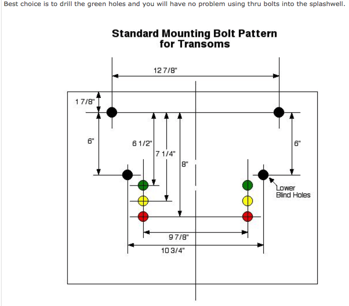

The anti-ventilation plate is directly above the propeller, and it needs to be 1-1/2 to 2-inches above the bottom of the keel. Typically this is expressed as two-holes-up or three-holes-up engine mounting height, when [the transom has been drilled] using the standard BIA bolt pattern.
Bottom line, you need to be down at least 3-inches from the old engine.
Setback exacerbates porpoising.
At either 377 or 402-lbs, depending on the model year of the 115, the engine is fairly heavy. The easiest way to mount the engine is to remove the bracket and fill the lower holes (use plugs NOT dowels) and re-drill the lower holes. Get some hardwood plugs at a woodworker supply store, dip them in epoxy, insert. Shave off excess. Cover end with Locktite Marine epoxy in white which dries to a very close Desert Tan.
For the lower engine mounting holes in the transom drill at the green or [yellow positions as shown below], and start with the engine mounted two-holes-up, that is, put the top bolt in the third hole counting down from the top.
Figure 1. BIA Engine Mounting Hole Location Diagram.

I am confused. How is a 20" shaft engine 3" above the keel? Is it still on the jackplate? Can it be lowered a bolt hole? Have you tried driving it yet? I have both of my outboards mounted ALL the way up on the standard pattern Phil shows above with no problems with performance.
