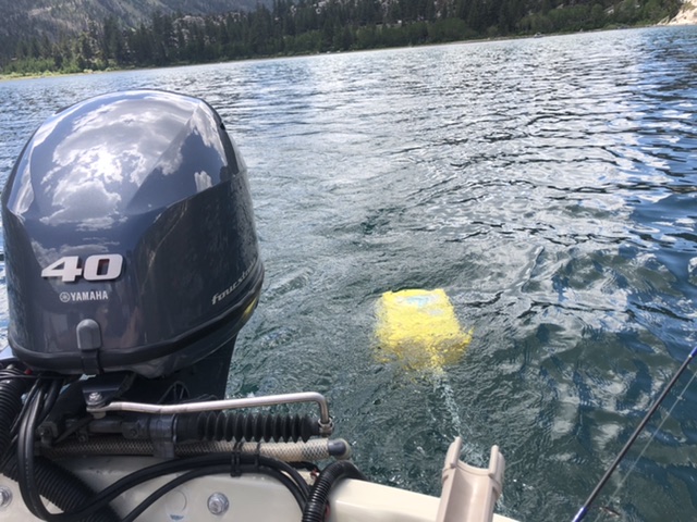

I would like to purchase two more propellers for different conditions:
—to be able to troll slower so I don’t have to tow buckets, and
—for offshore runs.
I may buy a stainless steel propeller or a four-blade propeller.
Suggest propeller for these purposes and my boat and engine.

To reduce boat speed at minimum engine idle speed, reduce propeller pitch from the current propeller pitch. But be observant of recommend engine speed limit at high throttle settings, as the engine will be able to accelerate to more than the recommended maximum speed with a low-pitch propeller.
I don’t understand what criteria you imply with your intended use “for offshore.” A 13-footer won’t be going too far from the shore.
There is no magic in a four-blade propeller for a 40-HP engine.
For a 40-HP engine an aluminum propeller is generally sufficiently strong. A steel propeller may have thinner blades and give improved performance at high throttle.
Re: 1977 13-footer Yamaha F40
Postby Phil T » Fri Jul 10, 2020 12:25 pm
You will not solve the trolling speed concern with a prop change. That is painting a pig.
Consider a trolling plate.
https://www.davisinstruments.com/product/happy-troller-small/
Postby jimh » Fri Jul 10, 2020 7:03 pm
Troll in reverse.

I did consider a trolling plate but I won’t use it enough to make it worth drillng more holes in the [anti-ventilation] plate. I already have a hydrofoil installed.
And I did try reverse for a while but the rod holders are mounted on the transom and the wind made it exhausting to control.
Postby Jefecinco » Sat Jul 11, 2020 10:19 am
Given the responses to your question towing a bucket may be your best solution. It may be inelegant but it is effective and virtually free.

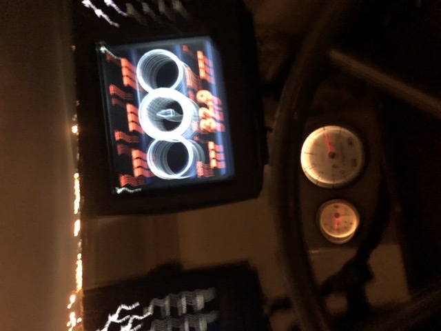

It was pretty choppy seas but I got a WOT of 6,000 rpm’s and 32.9mph.

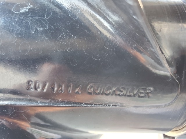

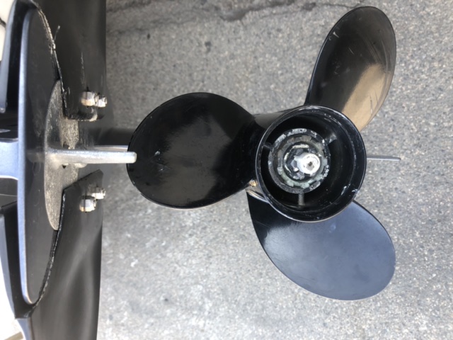

This is the marking on my current prop. (It’s very hard to read) Any suggestions if I should go up in size or pitch? I have room to go up in diameter.
I googled the # and was not able to find the exact #. I’m going to try and call quicksilver on Monday.
