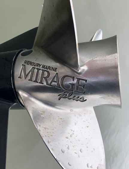

Photos of my prop:
*Branding: https://cimg5.ibsrv.net/gimg/www.thehulltruth.com-vbulletin/2000x1504/img_1291_5576d5ed2aa3bfe3f37c1d49b1d4e5addcb5dd5c.jpg
*Model number: https://cimg3.ibsrv.net/gimg/www.thehulltruth.com-vbulletin/2000x1504/img_1289_f1be2cbb4e5194642c99679b2798b06732fe52a1.jpg
*Non factory stamping (from repair work): https://cimg4.ibsrv.net/gimg/www.thehulltruth.com-vbulletin/2000x1504/img_1290_136e50e8e6e1bf88c8c03a199f462c761f019ab6.jpg

I see in your more recent images of the propeller that the brand and model are clearly identified. Here is a cropped and re-oriented version of the original.
Fig. 3. Photo of propeller under discussion; rotated 90-degrees and then flipped 180-degrees so the cast-in text is reading left to right and right-side up.
Yes, it is clearly a Mercury MIRAGEplus propeller.
You have inferred that some propeller shop has worked on the propeller based on some stamped numbers. That might be very true. But the notion that because a propeller shop worked on the propeller it is no long in specification is not an intrinsic outcome. The MIRAGEplus propeller is just a standard line propeller from Mercury, and perhaps the propeller was sent to a shop for custom balancing or other work. Or the pitch might have been slightly altered. There is no telling exactly what was done. From all the images you have provided, I don't see anything unusual.
Another variation in performance: propellers might work differently on different engines due to the design of the gear case. When I bought my MIRAGEplus propeller, initially testing was a bit disappointing, and my notes mention some ventilation or loss of grip. However, when I changed engines on my boat and put the same propeller on a different engine with a different gear case, I was completely pleased with its performance and there has never been any ventilation. In my case neither engine was Mercury. You'd think a Mercury propeller on a Mercury gear case would work in an optimum manner. And apparently Boston Whaler thought so, too.

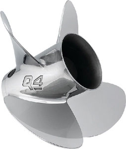

I have a new propeller whose dimensions are 14.6 diameter and 17 pitch
Photograph of a four-blade, stainless steel, polished, right hand propeller.
The propeller is a "Q4" and the part number 48-8M0103526.

Postby jimh » Sun May 02, 2021 3:24 pm
If the propeller shown above were a Quicksilver Q4 it should have a clear identification mark. See below:
Quicksilver Q4 propeller.
Also note that a Q4 has a flared exhaust hub. The propeller you illustrate above does not appear to have a flared exhaust hub.
A REVOLUTION4 has a rather long exhaust tube without flair.
A propeller sold as a REVOLUTION4 would have that identification clearly embossed on the propeller.
But the part number for a REVOLUTION4 would be 8M0151317.
I do not believe that one propeller can be both a REVOLUTION4 and a Q4 at the same time.

Postby jimh » Mon May 03, 2021 8:36 am
What name is embossed on the propeller shown in the image you posted on May 2, 2021?
roundle1979
Posts: 95
Joined: Thu Jun 13, 2019 11:10 am
Re: 190 Nantucket 135 OptiMax
Postby roundle1979 » Mon May 03, 2021 11:58 am
[The name embossed on the propeller is] "Q4."
The Q4 identification embossed on the propeller.

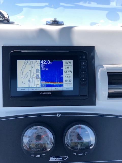

Small clarification about my above performance numbers:
I took my readings from my Garmin GPS (ECHOMAP Plus 74CV); my GPS is displaying KT rather than MPH. So, I believe my top end speed (37 KT) is actually 42.5 MPH.
This top speed is VERY similar to the top speed [of a 2003 Boston Whaler Nantucket 190 w/ 135HP Optimax] reported by Boston Whaler when the boat was launched at the Miami Boat Show in 2003: https://continuouswave.com/whaler/refer ... ucket.html
GPS Screen Photo
2004 Nantucket 190 w/ Mercury Optimax 135
Postby jimh » Wed May 19, 2021 11:01 am
Most GPS receivers in recreational grade chart plotters do not actually measure speed. They calculate speed from time and distance. It is possible to directly deduce speed from GPS signals using rather sophisticated methods, but I don’t think the typical GPS receiver in marine chart plotters does that. The speed value calculated with time-and-distance methods will be accurate to better than 0.5-MPH, which is really quite sufficient for propeller testing and analysis.
Generally any display of speed from a GPS receiver permits the user to choose the units of speed desired, so the distance can be any unit from meters or miles or nautical miles or kilometers, and the time can be in units of second or minutes or hours.
Nautical miles are a unit of distance used at sea and are derived from one minute of longitude, and are not in reference to land distance units which tend to vary by country.
A statute mile is 5,280-feet—whatever a foot might be.
A meter was intended to be defined as one ten-millionth the distance from the North Pole to the Equator on a meridian passing through Paris, but measurement errors in the 1809’s threw off the outcome.
Generally when operating a boat near land in the USA the unit of speed is the mile-per-hour, although some boasters seem to think the nautical mile per hour is, well, more nautical.
There is no telling where the SmartCraft display obtained its speed data. It could come from a Pitot tube sensor.
A Pitot tube sensor measures speed through the water. A GPS speed is speed-over-ground. The two can be very different if the boat is operating in moving water.
