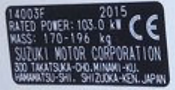

Here is the label on my Suzuki DF140a.
Fig 4. Photo from owner of DF140 showing emission label.
I don’t know what horse power this equals but it is obviously more than 127hp.
This engine is on a 2003 190 Nantucket. It has a t-top which adds weight and drag. With my family of four we can reach a bit over 40 mph. We enjoy tubing and knee boarding of which we have no problem doing with this set up.
I would say this engine for our hull as it is set up is “just enough”. It does the job for us. A 150hp would be nice but it would add more weight and I’m not the type to cruise around over 30mph anyway.
Maybe those dyno tests were performed on the earlier 140hp models before the ‘a’ designation. They may have had a lower dyno test rating.
Re: Dock Talk on Suzuki DF140
Postby jimh » Fri Sep 10, 2021 7:33 pm
MASABA--many, many thanks for showing an actual emission label from a Suzuki DF140a engine for 2015. The label indicates the power of the engine in kilowatts as 103-kW. To convert that to horsepower gives 138-HP.
Fig. 5. Close-up view of emission label on 2015 Suzuki DF140a engine showing 103-kW power rating.
The power shown on the CE emission label for the 2015 DF140 engine posted above is quite different than the recitations that the engine only makes "barely more than 50-year-old 115-HP" or the engine makes "117-HP" on a dynamometer test or that the engine makes only 127-HP as indicated on its emission label.
Showing an image of an actual label is THE BEST method to cite the value of engine POWER indicated on the label. Your photo-image of the label has contradicted all the "dock talk." Thank you.

That data from EPA shown above does not indicate that it applies to the DF140. The designator for "Engine Family" should appear on the EPA label. Compare with the label shown above on an Evinrude in Figure 6.
I believe someone once pointed out that all the Evinrude E-TEC engines using the 3.4-liter engine block were rated under the same "Engine Family" for EPA, and all were certified at the same horsepower output, about 250-HP. Some of those engine carried model designators and decals for "300" and some carried " 250 H.O."
Notice that the EPA compliance label generally does not have a power rating. Only the CE label has the power rating.
There has long been an understanding that these high-rotation-speed rated engines with four-stroke-power-cycle design only hit their peak power at the absolute peak of their allowed engine speed. And the power output curve is similarly shaped. Engines with a higher power output at lower engine speeds, often two-stroke-power-cycle engines, will be able to more easily accelerate under the load of a propeller at those lower engine speeds. See my article on Propeller Power Curve for some graphs that demonstrate how engines with strong power output at lower engine speeds will be able to accelerate better under load.
https://continuouswave.com/whaler/refer ... Curve.html
In order to obtain the rated maximum power output from any marine engine, the propeller must be chosen so that the propeller load permits the engine to accelerate into its maximum power output range. In the case of many (perhaps most or even all) four-stroke-power-cycle outboard engines, that means the propeller load must be chosen to permit the engine to accelerate to its very highest rated engine speed.
If any engine is not mated properly to a propeller, that is, the propeller load is too high, the engine speed will be limited, and the engine will only be able to accelerate to some engine speed below its maximum power output. The result will be less power output from the engine at full-throttle than the engine is rated to produce.

jimh wrote:That data from EPA shown above does not indicate that it applies to the DF140. The designator for "Engine Family" should appear on the EPA label. Compare with the label shown above on an Evinrude in Figure 6.
So if I understand you correctly "Engine Family" is for all the motors within a common family - same engine block size, design and other characteristics?
If that is the premise, then the engine family would apply to the Suzuki 115 and 140hp model as they use the same 124.7 cu in block and if that's the case then the EPA rating of 127hp is applied to the 115 model instead of the 140hp model I am suggesting. Is this what's being implied?
I highly doubt any engine manfacturer would underrate their motors by 12 horsepower and slap a 115 decal on a motor capable of 127.5hp. Is it possible that they are using the average of the advertized horsepower rating? This would seem to make more sense as the average of the 115/140 family is 127.5hp and that's the rated power in the EPA family, BUT then applying this to the 2020 Evinrudes wouldn't add up when looking at the 3.4L displacement models since there's multiple ratings for the same displacement and these separate horsepower ratings are broken into different families. For the sake of Evinrude we both know the 3.4L block was used in models 200HO, 225HO, 250, 250HO and 300.
More questions than answers on what is the real horsepower of the Zuke 140.

I can’t offer a definition for the EPA term “engine family.” I just infer it means engines of similar emission characteristics, which I then also infer means engines of similar power output so thus covered by the same regulations, and engines with similar rates of output per horsepower-hour of the regulated emission components.
To make power the engine consumes fuel. The more power produced, the more fuel consumed. The more fuel consumed, the more exhaust emitted.
Engines of very similar design should have—really must have—the same thermal efficiency in converting fuel to power. An engine that is producing 140-HP must consume more fuel than a nearly identical engine producing 115-HP. The only way an engine becomes more fuel efficient is through significant change in its design. No engine maker would create similar engines with different horsepower-rating by intentionally making the the lower-horsepower versions less efficient than their higher-horsepower model of nearly identical design. To make more power output (with no significant change in design) the higher-power-rated engine must burn more fuel.
On another aspect, if the DF140a only made a tiny bit more horsepower than the 115-HP model, I would expect that on-water performance test reports would reveal this.
