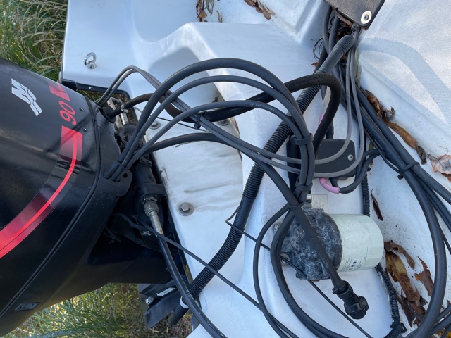

Fig. 1. One of the bottom engine mounting bolts can be seen just behind all the cables and hoses.

Regarding the rigging seen in Figure 1:
I would pull the extra engine electrical harness cable forward in the rigging tunnel and store the extra cable under the console. This will improve the rigging in the following respects:
  • the transom will be much neater
  • the extra cable won't be exposed to seawater and sunlight
  • the drag on the engine when turning will be less without all the extra cable weight to pull around
  • there should be enough room under the console to neatly coil the excess.
You should verify the engine mounting holes in the transom at at the BIA template locations. See the article in the FAQ on engine mounting hole locations in the transom.
Q9: What is the Standard Transom Hole Layout?
https://continuouswave.com/whaler/reference/FAQ/#Q9
I don't see the fuel hose primer bulb in Figure 1. The primer bulb should be inserted in the fuel supply line near the engine so the primer bulb is oriented vertically and the arrow on the bulb points skyward. See the article
A PRIMER ON PRIMERS
https://continuouswave.com/whaler/reference/primer.html
In Figure 1 I see a fuel filter mounted exposed to the air and water with corrosion. If you have to keep the fuel filter exposed to the elements, get a fuel fitting manifold that has a a white weather resistant finished or is chrome plated.

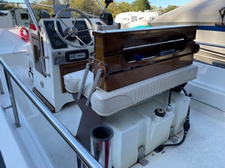

Fig. 2. Location of fuel tank under reversible pilot seat. Note fuel primer bulb.
The in-line fuel primer bulb is near the Moeller Tank under-RPS. I have been given advice to move the primer bulb to be near the engine, and also advice to leave it where it is located now. I had decided to just leave it, but after reading the information provided by jimh, I will probably relocate the bulb and install it so it is vertical.

As seen in Figure 2 above, the orientation of the primer bulb is vertical, but the direction arrow indicating fuel flow is pointing downward. Orientation of the primer bulb should be with the direction arrow indicator pointing upward. This will cause the check valves in the primer bulb to work much better, and obtaining a stiff primer bulb with a few pumps will become possible.
