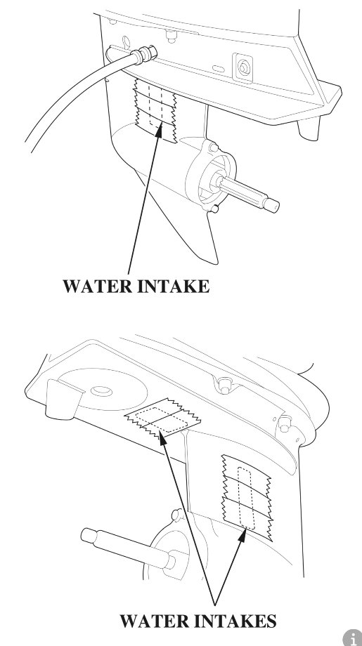

I have a 1979 SPORT [15] with a 2016 HONDA BF50 mounted all the way down. I plan on raising the engine to be mounted two-holes up.
The HONDA BF50 has three water pick-up inlets. Two of them are in a typical location. One is on the underside of the Anti-Ventilation plate. [See Figure 1 added later in the discussion.]
When the engine is raised to be mounted two-holes up, the water pick-up under the A-V plate will be out of the water.
Will engine cooling water be remain sufficient when the boat is on plane?
I have no way to read the engine cooling water pressure.

When Phil reached out to me, I wasn't aware of the 3 water pickups on the Honda lower unit, especially one under the cavitation plate, which is a very unusual place to have a water intake. Very strange that they would do that.
Is this motor a 15-inch or 20-inch shaft? If a 20-inch shaft, I don't foresee a problem [with cooling water flow loss] as the 15 hull can accommodate a high-mounted engine. The old school using a flat edge along the hull bottom does not provide a real life indication of proper mounting, but does give you a starting point. I can attest that a 15-footer with a Yamaha F70 can be run 6-inches-higher than the transom and not have any water intake problems. With the Honda set-up, just watch your water tell-tale stream when you first test the higher mounting position.

The location of the water inlets on the 2016 HONDA BF50 engine are shown in Figure 1.

Thanks for providing an illustration showing the location of the cooling water inlets on the engine lower unit. That water inlet is unusual. I don't recall mention of a water inlet in that location on other engines, such as the engines shown in several illustrations above depicting raised engine mounting heights.
As long as the anti-ventilation plate remains immersed in the water or just at the water level, the inlet on the lower side of the plate will continue to function as a water inlet. I infer that water flowing around the gear case bullet will be deflected upward and toward the inlet on the lower side of the anti-ventilation plate, and that flow should result in good inflow of water at that point.
Water coming off the transom of an outboard engine boat tends to rise upward, so when the boat is on-plane the water level at the anti-ventilation plate will be higher than the water coming off from under the transom. This is why outboard engines can typically always be mounted so their anti-ventilation plate is located higher than the hull bottom at the transom.
