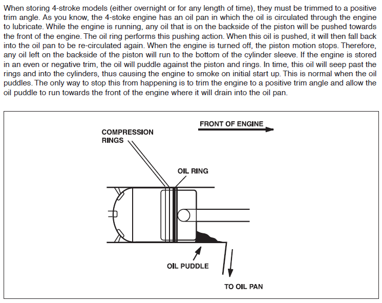

I have put a few more hours on [the Boston Whaler STRIPER 15 with Mercury 60-HP engine] rig. I ran [the STRIPER 15] down to Pescadero Beach from Pillar Point Harbor, Half Moon Bay, about 18 miles, and [the Mercury 60-HP engine] burned 2-gallons per the Smartcraft gauge. Then I ran [the STRIPER 15] around, fished for 3-hours, and ran back at 23 to 25 nautical-miles-per-hour in slightly bumpy seas; [the Mercury 60-HP EFI engine] burned 5.8-gallons.
The [STRIPER 15] ran very well. The [Mercury 60-HP EFI] engine never misses a beat, except:
--it made a slight squeal noise (from a belt perhaps)
--it made a smoke puff for three to four seconds every time it started.
Is [the smoke puff for a duration of three to four seconds during engine starting due to] the fuel enrichment adding more gasoline? I thought only carburetor engines did that.

FISHNFF wrote:Is [the smoke puff for a duration of three to four seconds during engine starting due to] the fuel enrichment adding more gasoline? I thought only carburetor engines did that.FISHNFF
An EFI motor will also enrichen the fuel mixture during a cold start, similar to what a carburetor model will do, but I don't think this is your problem. Excessive fuel will be blackish smoke. Excessive oil will be bluish smoke.
If a four stroke is left trimmed down then over time a bit of oil will migrate past the piston rings and get into the combustion chamber. The motor will then emit puff(s) of smoke when next started. To see if this is the situation with your motor try trimming the motor up a bit when it is not being used. See if this mitigates the smoking concern.
oil smoke.png (72.59 KiB) Viewed 64856 times

Thanks for the oil seepage remarks. I don't think they applies because the smoke will occur each and every time I start the motor, whether it sits ten seconds, ten minutes, or ten days. And the smoke does not look blue. And it is not steam.
I am inclined to think it is a little extra shot of fuel is the cause. Not a big concern, just an observation. I'll check with the dealer.

ALLOY--that is a very interesting observation regarding oil getting into the combustion chamber based on the orientation of the engine after shut down. Thanks for that information.

[The Mercury 60-HP FOURSTROKE engine] had an intermittent rough idle. A dealer thought [the cause was a part called the] Idle Control Valve. [The dealer is located] a bit far from where the boat is stored. and the dealer service department was swamped; I just ordered an Idle Control Valve. To [remove the old Idle Control Valve and install a new Idle Control Valve in the Mercury 60-HP FOURSTROKE was a] five-minute swap, and the engine has never ran so well.
I guess the [problem of the intermittent rough idle had] progressed slowly. Now there is no sputter or bogging down.
