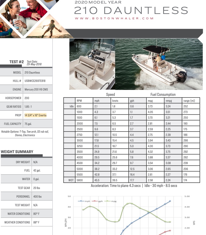

You must be are making reference to the factory performance report shown below. The factory performance test report is a marketing piece.
Fig. 1. A portion of a Boston Whaler performance report for a boat similar to the boat under discussion.
Pay close attention to the test details:
  • the test boat has only 20-lbs of gear; Your boat most likely has an anchor, chain, and rode that weighs more than that. Also include any personal items, cooler, gear, tools, etc.;
  • the test boat had 0-gallons of water; your boat?
  • the test boat had 42-gallons of fuel; Your boat had 75-gallons;
  • the test boat did not have bottom paint;Your boat?
  • the test boat was in protected 80-degree water, no tide or current—ideal conditions; your boat?
Verify your propeller is the same supplied by the factory, an ENERTIA 14-3/4-inch x 16-pitch.
Verify you trimmed the engine as far as possible when you recorded the engine speed and boat speed. Failure to fully trim the engine will result in a loss of as much as 5-MPH boat speed.

Saildoc wrote:It seems that my boat and engine are performing close to normal operating range.
The total boat weight in your test appears to have been heavier than the factory test boat weight. The expectation is for a reduction in maximum boat speed. To know precisely that the outcome of a loss of 5-MPH in top boat speed is normal and due entirely to added weight is speculative. Other factors could have contributed.
A better test will be duplicate as closely as possible the boat weight and test conditions of the factory test report, then compare engine speed and boat speed. Your boat should be able to closely match the factory boat if everything is “normal.”
