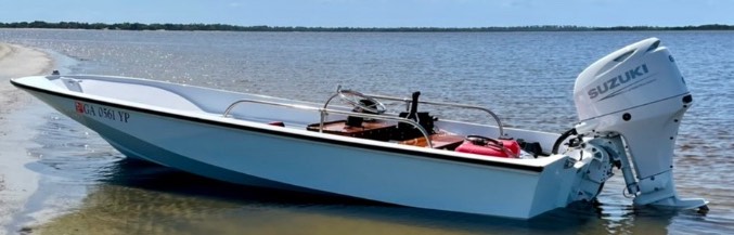

Test results from recent re-powering of a SPORT 15:
BOAT: 1978 SPORT 15
ENGINE: 2023 Suzuki DF60a
TEST CREW: two adults
FUEL: 6-gallons
PROPELLER PowerTech
FAMILY or MODEL: TBA
MATERIAL: Stainless steel
NUMBER OF BLADES: TBA
PITCH: 17-pitch
DIAMETER: possibly is 11.25-inches
Wide-open Throttle Performance
ENGINE SPEED: cited only as just below the rev-limiter of 6,300-RPM
ENGINE TRIM: cited as 6-percent
BOAT SPEED: 42 to 43-MPH
BOAT SPEED and FUEL ECONOMY: see below.
Fig. 1. 1978 SPORT 15 with SUZUKI DF60a

The boat looks very nice with the white engine paint.

[As seen in Figure 1 above the SUZUKI DF60a engine] looks big or oversized on the transom of the SPORT 15.
Q1: how does the size of SUZUKI DF60a compare to the YAMAHA F70?

The DF60a engine does appear in Figure 1 as a rather large engine for the SPORT 15, but I think that appearance is related to the way the boat is arranged in the photograph and the position of the camera.

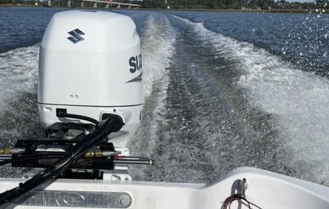

The Suzuki DF60a has a small gear case, which accounts for some of the [difference] in engine weight [perhaps means compared to the Yamaha F70 engine which by inference is presumed to have a large gear case].
Fig. 2. Engine mounting and clean wake when at speed.

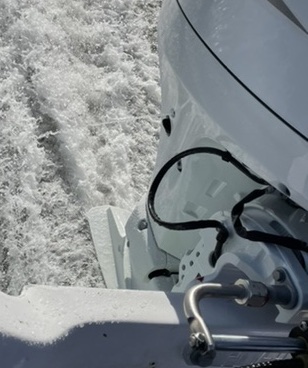

Fig. 3. The gear case position relative to water flow at speed.
The appearance of the engine as being "large" may be due to the engine mounting height in use. The [shallow splash well of the SPORT 15 boat] would not allow the engine to be mounted any lower.
The data [given in an earlier post to this thread] were [computed from the speed solution] from a GPS receiver; the engine trim was at "zero."

Figure 3 shows a very nice orientation of the anti-ventilation plate relative to the flow of water around the gear case. I do not see any need to increase the trim OUT from what was used when this image was photographed. The TRIM looks perfect.

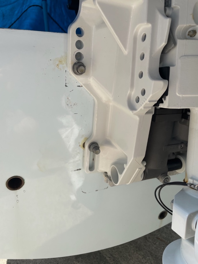

What is the engine mounting height of the DF60a engine on the SPORT 15 as measured in units of holes raised from the lowest possible position?
(Second request for this information; reports of performance should always mention the engine mounting height.)

[The engine mounting height is shown below in Figure 4; the engine mounting height is three-holes-up from lowest possible position.]
Fig.4. Engine mounting at three-holes up position.
