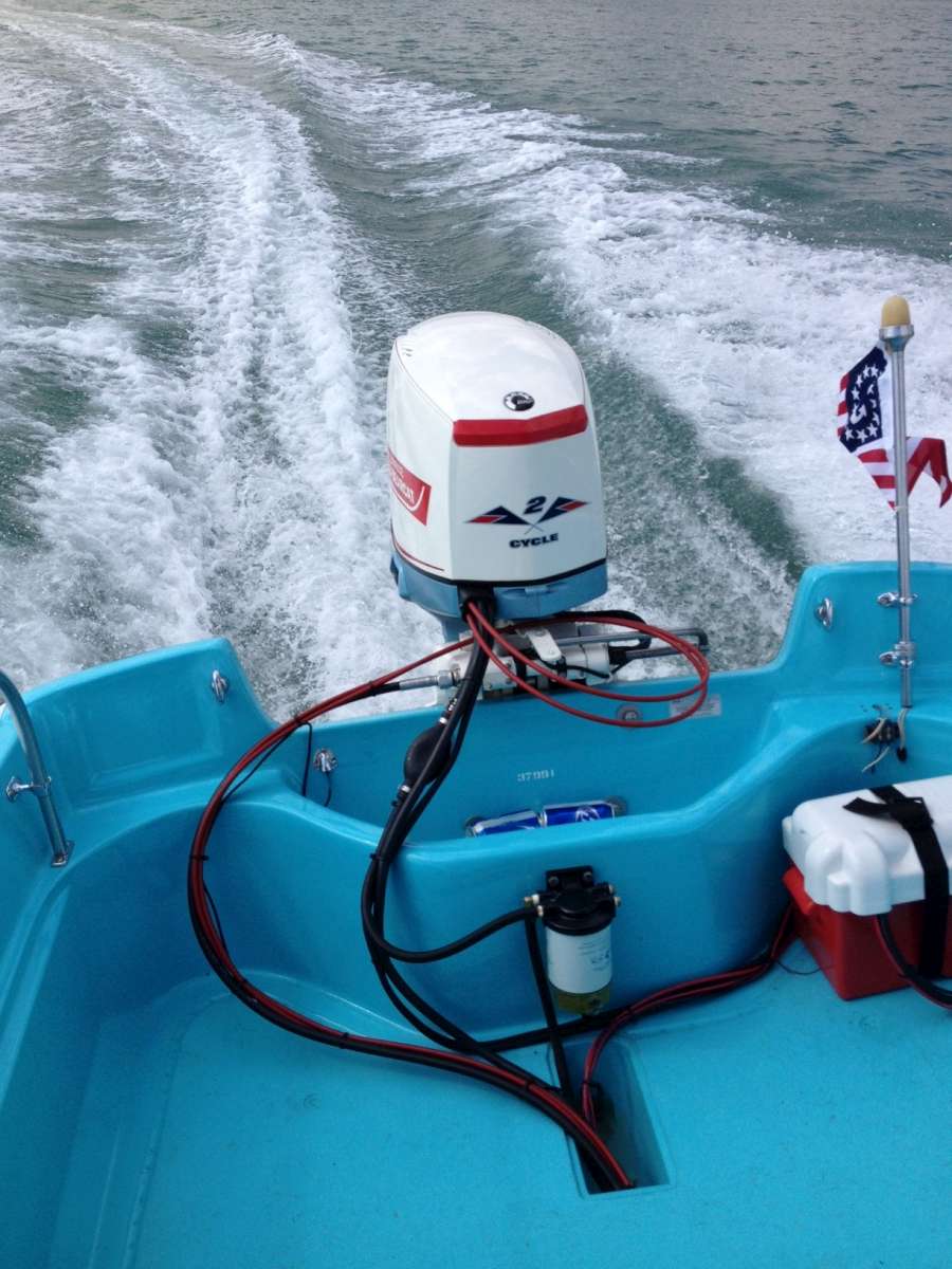

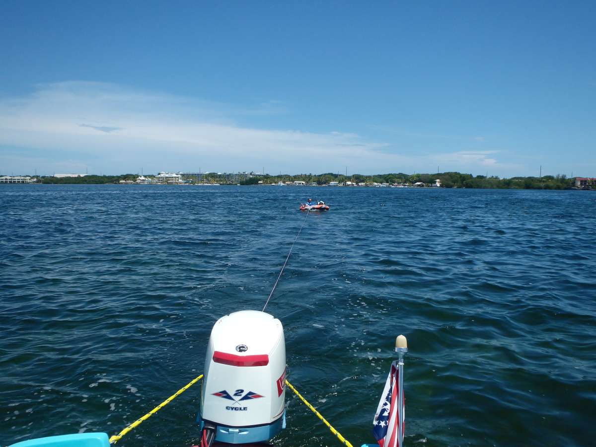

The E-TEC 90 can pull me up on one ski with three adults in the boat and coolers. That's with a 17-pitch Viper. I'm 180 lbs and in my older age, I get up with my back foot out. Anyone that's ever skied for real knows that slalom speed is 36-MPH, and I will tell you that even with the bimini up, we aren't full throttle at that speed. For skiing and tubing, the E-tec will do it easily.
Chris
