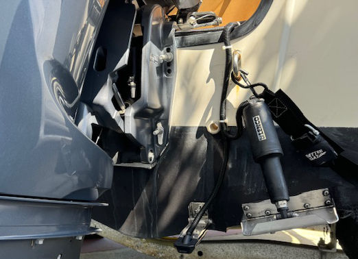

When I brought my boat to the shop, I did mention [that I wanted the engine to be mounted in the two-holes-up position] but the technician said [mounting the engine at two-holes up] would be too high. With this outboard, there are only four holes [instead of five holes] to choosef rom for [the] top mounting [bolt position], and I see that if the [the two-holes-up mounting were used then the engine] would be [mounted] too high.
I am really glad that I decided to add Lenco 9x9 Electronic Trim Tabs as they really helps this hull.
Fig. 1. This view of the transom shows the engine mounting height is One-Hole-Up, and also shows the location of the LENCO 9x9 trim tabs, which are mounted rather close to centerline, with tab inboard end abutting the thicker section of the transom.

Re: 1998 Outrage 17 II with Yamaha F150XCA
Postby jimh » Thu Aug 22, 2024 10:45 am
MisChief15 wrote:I am really glad that I decided to add Lenco 9x9 Electronic Trim Tabs as they really helps this hull.
You seem to have mounted the trim tabs as close as possible to centerline, which limits the effectiveness of the tabs. The farther out from keel centerline the tabs are placed, the more effect they have on balancing lateral trim. With close to keel centerline mounting, the tabs probably work fine for adjusting the fore-and-aft trim (raising or lowering the bow), but they won't be as effective on side-to-side (port or starboard lean) trim.
Did you get advice from LENCO about the tab mounting position on the transom in terms of how far outboard from keel centerline would be the best fit?
Postby MisChief15 » Fri Aug 23, 2024 3:07 am
I did not consult with Lenco about the location [of the trim tabs]. The location was chosen mainly so that it doesn't interfere with trailer [bunks] on both sides.
Postby Jefecinco » Fri Aug 23, 2024 11:26 am
When fully retracted trim tabs should be as close as even with the hull bottom as practicable. They should not interfere with the trailer bunks if properly mounted anywhere on the transom.
Do your electric trim tabs retract when the ignition is turned off?
Repositioning the trim tabs to a more outboard position over the winter would be an easy project if after using them as is for a few weeks indicates any value in moving them.
When it comes to re-sale a more usual trim tab mounting would be helpful.

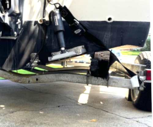

Postby jimh » Fri Aug 23, 2024 3:12 pm
In Figure 2, below, the trailer bunks appear to be extending well past the boat transom.
Fig. 2. The trailer bunks appear to extend well past the transom, or in another aspect, the boat has been positioned too far forward on the trailer.
Do the trailer bunks actually extend past the transom, and if so, by how much?
Generally there is not much value in having the boat position on the trailer so that the boat transom ends up being pulled so far onto the trailer that the trailer bunks are extended farther aft than the transom.
To base the location of the trim tabs on the basis they would be liable to strike the trailer bunks when the boat is loaded on the trailer because the boat must be hauled forward and onto the bunks is not the best criterion for where the trim tabs ought to be placed.
It would be simpler to reposition the boat on the trailer so the transom was at the end of the bunks, or even to cut off a few inches of the bunks so they did not extend farther aft than the transom.
