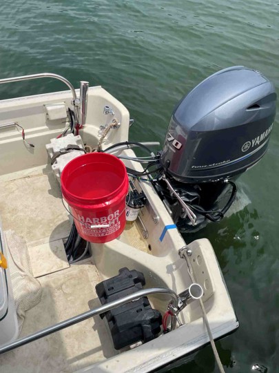

This is as close as I could come to fulfilling jimh's request for an experimental measurement.
Figure 1. Two batteries, each weighing 43 lbs, and one bucket with 4.5 gallons of lake water. The weights are about 14 inches from the top of the transom.
BW transom.jpg (63.65 KiB) Viewed 3033 times

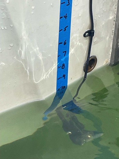

A tape perpendicular to the water was attached to the transom and marked off in inches. The distance from the transom to the water level was initially measured with no added weights. Weights added were two batteries (each 43-lbs each) and about 4.5 gallons of lake water (37-lbs)
Results:
No added weight -------------------------- 11 inches
2 batteries added (86 lbs) --------------- 10 inches (Figure 2)
2 batteries + 4.5 gal. water (123 lbs) -- 9.25 inches
Figure 2. Transom distance after batteries were added.
BW transom distance 2.jpg (42.62 KiB) Viewed 3033 times
My transom is angled back by about 9 degrees, so for better accuracy the results should be multiplied by 0.988 (cosine of 9 degrees). Looks like your calculations were not far off. These numbers might have been closer to yours if I could have placed the weights right at the transom. Note that the changes aren't linear: 37 lbs. of water gave a depth change that was 75% as much as 86 lbs. of batteries. Perhaps this is because water began entering the splash well drains when the bucket of water was added.

Many thanks for taking the time to perform a carefully controlled experiment to assess the variation in rate of change of the freeboard at the transom caused by added weight on the transom. I really appreciate your efforts. I just this moment came across your post, and that caused the delay in my reply.
One other possible cause for the rate of change (in the influence of weight on freeboard) to vary would be the shape of the hull varies as it becomes more deeply immersed. Because of a slight flair to the hull sides and transom, the hull creates more buoyancy as it is pushed deeper into the water by added weight.
Your observation, that at some point of immersion, additional water comes aboard via the (now submerged) engine splashwell drains is a very good assessment. For example, if the weight added becomes extreme, at some point the top of the transom will be below the water line, and a very drastic change in total immersion of the hull will take place, producing a very non-linear outcome.
