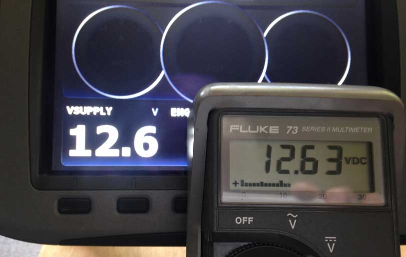

I compared the voltmeter in my Lowrance HDS-8 when reading its SUPPLY VOLTAGE to a FLUKE Model 73 Series II DVM. The Fluke is rated for 0.3-percent basic accuracy on measurement of DC voltage. The results:
--FLUKE Model 73 read 12.63-Volts
--LOWRANCE HDS read 12.6-Volts, with occasional flicker to 12.7-Volts
The LOWRANCE was connected to a power distribution panel with the OEM power cord, about 2-feet long. The FLUKE was also connected to the same power distribution panel with its test leads. With the FLUKE rated for 0.3-percent accuracy, a reading of 12.63 would have a range of
12.63 × 0.003 = 0.0378-Volt
Thus the Fluke reads the voltage as somewhere between 12.6678-Volts and 12.5922-Volts. The Lowrance HDS reads 12.6-Volts. I grabbed this image to preserve this measurement data:
I am impressed with the accuracy of the voltmeter in the Lowrance HDS. When it reads the supply voltage as 12.6-Volts, I am quite confident that is very close to the actual supply voltage.
