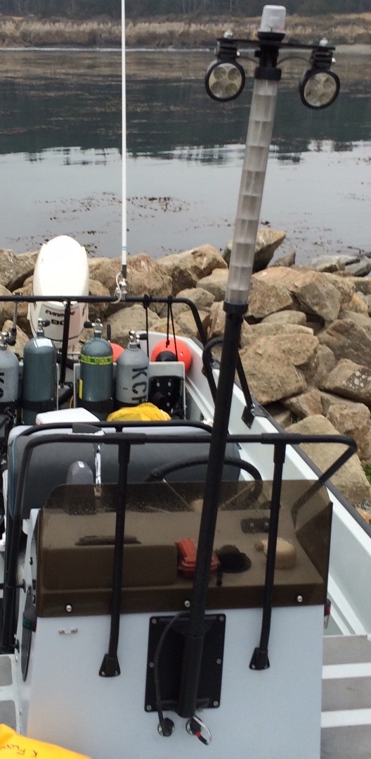

Hello. I have a removable mast on the console of my Guardian Divemaster 17. I have LED deck lamps (wired together) and a navigation lamp on the mast, so four electrical conductors. The mast wiring plugs into the front of console via two Perko watertight deck connections (Mfg # 1189DP0CHR). They aren't secure enough and after a while the connections become intermittent. Photo is attached.
Does anybody have a suggestion for a better product? I would prefer to use a single four-pin deck connector, but haven't found one I really like. Currently all I've found is a Hella product (Mfg # 002 957 801), but would be interested if there are other products that I should consider.
I'd like something that's waterproof when connected, and has some sort of waterproof cap when not.
Ideas are welcome.
Thanks, Gavin

Thanks for the tips. I think the more waterproof plug would be worthwhile because the front of my console takes a bit of splash in waves, perhaps more so on the Divemaster because the console is mounted farther forward.
I'm also considering trolling motor plug/receptacles. Examples are Marinco 12VCP, TH Marine TMFR-1-DP/TMBMP-1-DP. Unfortunately they're usually a little big for my application.
Still looking....

I have another idea: stop using the existing system of having a cable exit from the support pole and having a loose cable that connects to a panel mount. Instead, convert to having the power cable for the lamp run inside the support pole. Re-wire the power source cable so it is available inside the support socket on the end of a short cable. This will accomplish several things, all being improvements:
--cleaner look for the installation as no loose wiring
--much improved splash protection for the electrical cables
--much improved damage protection for the electrical cables
There are many cable-end connectors available which would do a good job for the cable-to-cable connection. For example, Ampseal16 connectors.

Due to the way the mast fits into the bracket, it would be difficult (but maybe possible) to do this as you suggest. I'd also have to figure out a way to get the wire pigtail to go up the center of the mast as it was being slid into the bracket. You're right that it would be a nice clean installation if it was all hidden away and protected inside the bottom the mast and the bracket.
Along the way, I found another interesting product. It's the Aqua Signal Model #315168 connector. I think it's intended for mast wiring in sailboats, specifically a deck-stepped mast. It angles 90 degrees from the mounting surface, so in my installation the wire would make a clean loop to the bottom of the mast or other exit point, rather than sticking straight out of the front of the console.

I received the Aqua Signal connector today. The basic idea looks great, but the material isn't very strong. It would be a very nice part if built out of metal. Also, pulling the plug out of the socket takes a lot of force. Given how light the material is, I'm wondering if the mounting tabs will break off after a few cycles. I'll try lubricating the O-ring to see if that lets it slide out easier. The retainer clip is very light too, so it will have to be handled gently.
So, exactly the design I want, but not quite the construction.
