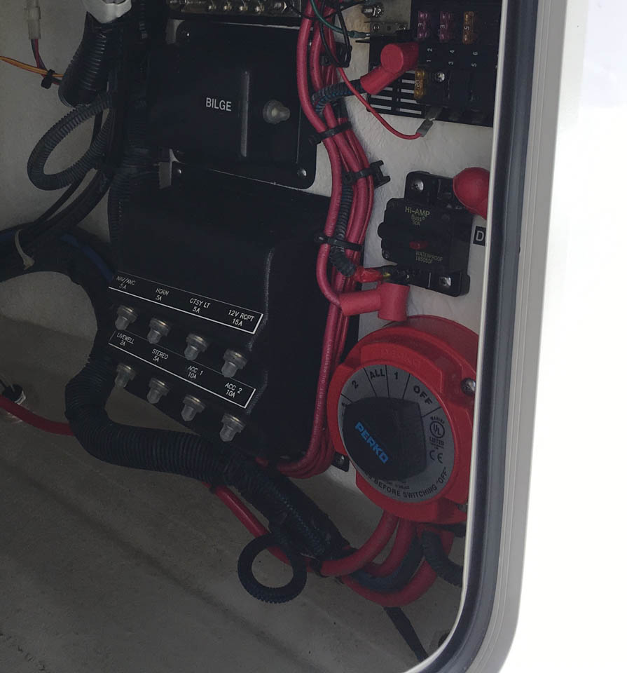

I have the same-size Perko dual battery switch. I noticed that the negative original battery has a wire of 8 or 10-AWG that I think runs to the main ground bus. Do I need to have one of those running from the new second battery to that same bus? I am figuring I do.
Also I have five-foot AWG-4 red and black cables with factory ends. The original looks like it may be heavier wire, maybe 2-AWG, but can't read on the original wire.
Thanks for any help--M

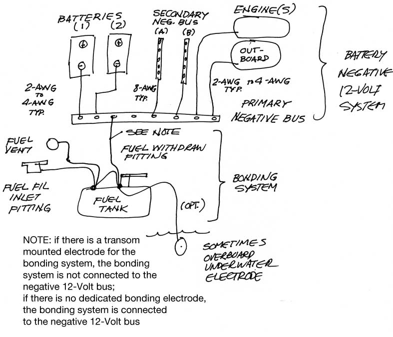

In any configuration of more than one battery in a 12-Volt primary power system, the NEGATIVE terminals of all batteries in the 12-Volt system should be bonded together by conductors that can all carry the full current necessary. For example, if there is an outboard engine to be cranked over and started, and if the engine cables are made of 4-AWG, then the negative terminals of all the batteries should be connected together with a conductor of at least 4-AWG.
If the existing installation has a dedicated main or primary power negative bus bar, then the negative terminals of all the batteries in the 12-Volt system should be connected to the primary power negative bus with conductors that can handle the maximum current. If the existing single battery used 4-AWG, then use 4-AWG for the second battery.

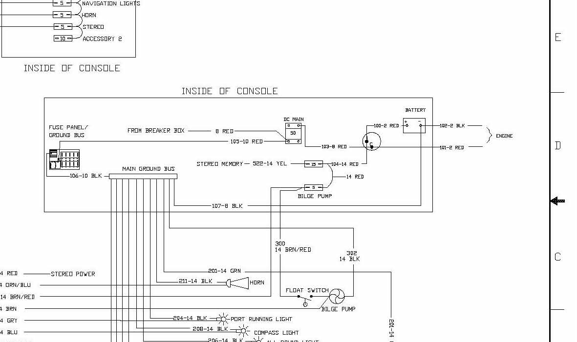

Re "main ground bus" on fiberglass boats: I am not sure if you are describing a separate and dedicated ground bus, or if you are describing just the negative bus of the 12-Volt system. On a fiberglass hull boat there is typically no "ground" for the hull because it is not a conductor. However, there is a bonding system for all metallic elements of the fuel system such as filler inlets, fuel withdrawal plates and fittings, and even non-metallic tanks. This bonding system ties all the components of the fuel system together, and then generally connects them by a single lead to the 12-Volt negative primary or main power bus. On some older boats, typical on c.1980 Boston Whaler boats, there was a dedicated electrode on the transom that was used as the seawater ground connection. On newer boats the negative bus is usually used as the bonding system ground point. See my sketch below.

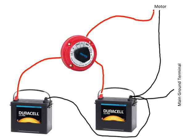

Here is simple diagram.
I realize both batteries can not be charged at the same time. Switch says I can with from A to B but not to off while motor running.--M

Postby jimh » Sun Sep 03, 2017 9:56 am
InVision wrote:Should I connect the negative batteries together? Or run an 8-AWG wire from second battery to the ground block?
Based on the factory wiring diagram for a single battery, it appears that the 12-Volt negative bus (which is called MAIN GROUND BUS in the drawing) will not carry any engine starting current. The 8-AWG conductor is insufficient to carry engine starting current, and it is also likely the size the negative bus is not appropriate to carry engine starting current.
Since you want to have two batteries available for engine starting, you MUST connect the negative terminals of the two batteries in common with a conductor that can carry the engine starting current. That conductor should be 2-AWG, based on the factory drawing showing that the cables carrying battery power to the engine are 2-AWG.
You won't have a real primary 12-Volt negative bus; the battery terminals themselves, connected together with a 2-AWG conductor, will serve as the primary 12-Volt negative bus. The 8-AWG conductor from one of the battery terminals to the bus marked in the drawing asMAIN GROUND BUS will bond that bus, now really the secondary 12-Volt negative bus, to the primary 12-Volt bus (the battery terminals).
Or, if you want--although not mandatory to have--you could install a new, much larger capacity, bus. To the new bus, which will be then the primary 12-Volt negative bus, you will connect the engine negative cable, the negative terminal of all batteries in the 12-Volt system, and the 8-AWG feed to the secondary bus (that is called MAIN GROUND BUS in the drawing). That is exactly what I drew in my sketch.
I have now described my recommendation in both a narrative and in a sketch. I am now out of ways to describe it, except perhaps to start taking pictures of the wiring--which I cannot do because I don't have any example to photograph. I hope that by words and by sketch I have communicated my recommendation.

InVision wrote:Here is simple diagram
Your pictorial sketch shows what I described in my narrative and schematic diagram; the negative terminals of the battery are bonded together. Use 2-AWG for that connection.
InVision wrote:I realize both batteries can not be charged at the same time.
No, that is not the case. If the switch is in the BOTH position, and if the engine is running, the charging current from the engine will be shared between the two batteries.
InVision wrote:Switch says I can with from A to B but not to off while motor running.
Actually, what the switch says can be seen in the drawing; the switch says: STOP ENGINES BEFORE SWITCHING "OFF'"
Perhaps you meant to say that you must not move the switch to OFF while the engine is running, but can move it from 1 to ALL to 2 or back.
In order to be able to move the switch among 1, ALL, and 2 positions and have the engine running, the switch must be a make-before-break action. I recommend you check the switch action with a continuity tester to verify that the switch you have actually has make-before-break action.

Getting back to my earlier comments about the difference between ground and negative circuits, if you look closely at the whole wiring diagram for the Boston Whaler 2004 190 NANTUCKET, you will see precisely what I showed in my sketch. There are several conductors in a BONDING system which tie together elements of the FUEL SYSTEM. In the Boston Whaler PDF file (see below for link), you can clearly see these conductors. They are identified as having GREEN insulation, associated with ground. They connect to the same elements as I diagramed in my sketch: the fuel tank and the filler. This circuitry appears in the drawing sector 2-A (lower right). (The wires in close proximity with PINK insulation are associated with the fuel tank resistive level sender, not the bonding circuit, and carry the fuel tank level sender signal to the tank level gauge display devices.)
As I mentioned earlier, if the boat does not have a dedicated submerged grounding electrode, the bonding system is then tied to the 12-Volt battery negative bus, and, indeed, that is exactly what occurs in the Boston Whaler 190 NANTUCKET drawing.
The confusion arises because in the factory's drawing they refer to the 12-Volt negative bus as MAIN GROUND BUS. The bus is really the 12-Volt negative bus for the HOUSE loads, and the bonding system is tied to it. The attachment to the sea occurs via the outboard engine. The negative circuit of the 12-Volt system going to the outboard engine is bonded to the powerhead of the engine. Other metallic components of the engine with exposed metal surfaces like the sacrificial anodes are in contact with the seawater. They provide the link of the boat's 12-Volt negative circuit to the "ground" or in this case the sea.

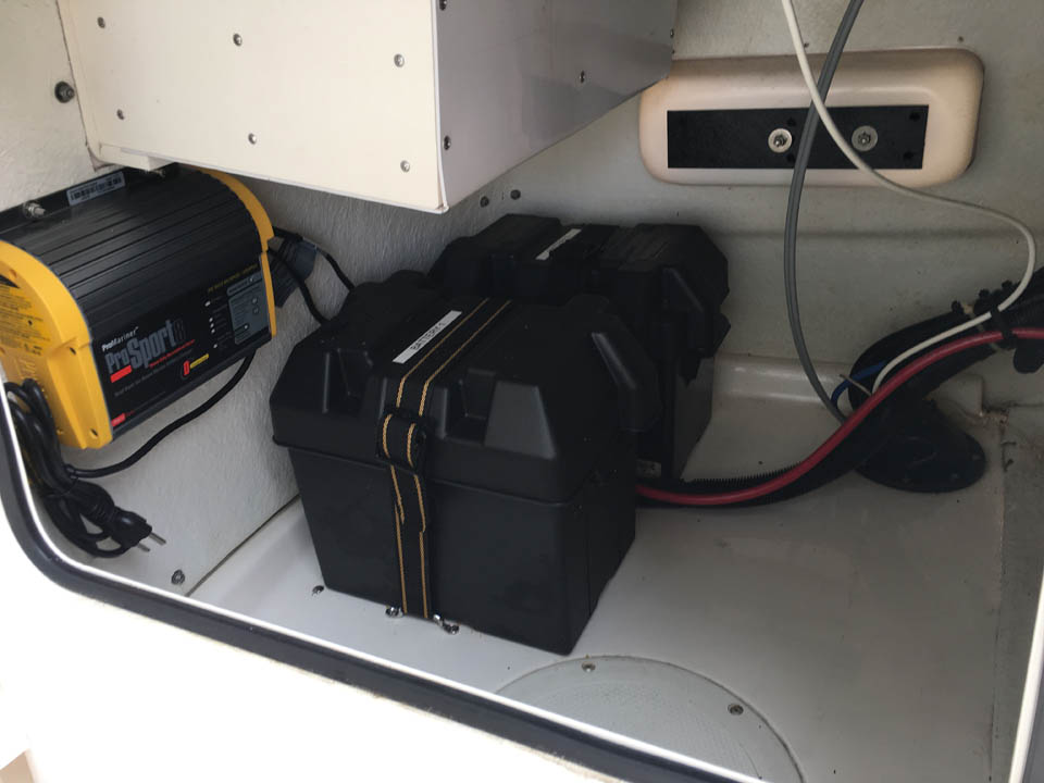

If did not already have an extra charger left over from the SeaRay I would be considering the Blue Sea Systems 7605. I am going to install just the basic system for now. Battery, battery box, 2-AWG wire, and Perko switch were only $140.
I am not sure how to get 120-V AC dock power into the console without cutting a hole for cord or mount a connector.

Postby InVision » Fri Sep 08, 2017 4:18 pm
Well it is done. Basic dual battery and charger/maintainer for dock boat lift. Thank you for all the replies.
M
Boat Photos
Re: Dual Battery Setup on 2004 Nantucket 190
Postby jimh » Sat Sep 09, 2017 12:13 am
You did a nice job on the installation. Good work.
I just noticed that the action on the PERKO switch has the OFF position in the full-clockwise direction. That seems backwards to me. Devices that control electrical current usually are oriented so that full-counter-clockwise is the OFF position. On a rotary switch, you usually turn the knob clockwise to move to ON from OFF.
Maybe the guy who designed the PERKO switch was formerly a plumber and was accustomed to valves in plumbing that you turn clockwise to shut off flow.
For a comparison, the Blue Sea Systems and the BEP Marine battery switches have the opposite action from the PERKO--you turn them clockwise to go to ON from OFF. Compare at
viewtopic.php?f=9&t=2627
I never noticed the PERKO switch has such an unusual action-direction.

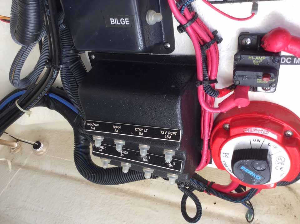

Same as original OEM Perko single switch that cam eon Boston Whaler.
M
original OEM switch.jpg (99.5 KiB) Viewed 17697 times
