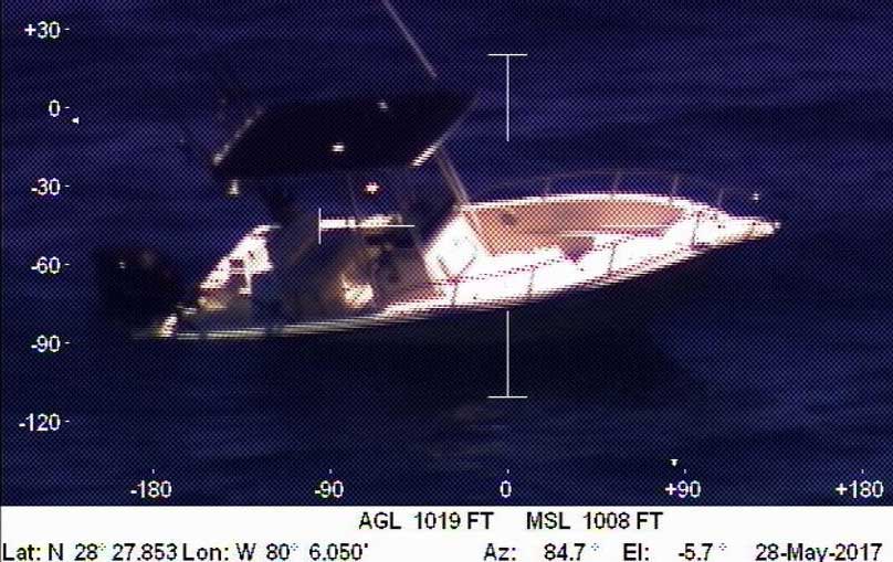

The Coast Guard also posted images of the boat, which was still afloat and in a normal orientation, although down by the stern.
The camera was in position
Lat = 28° 27.853' N
Lon = 80° 06.050' W
The time stamp [which I have cropped out in the image to reduce the width] indicates 16:04:37L. If "L" is for local time, that would be 4:04 p.m. The Az/El data appears to be relative to the aircraft, and probably not a compass bearing.

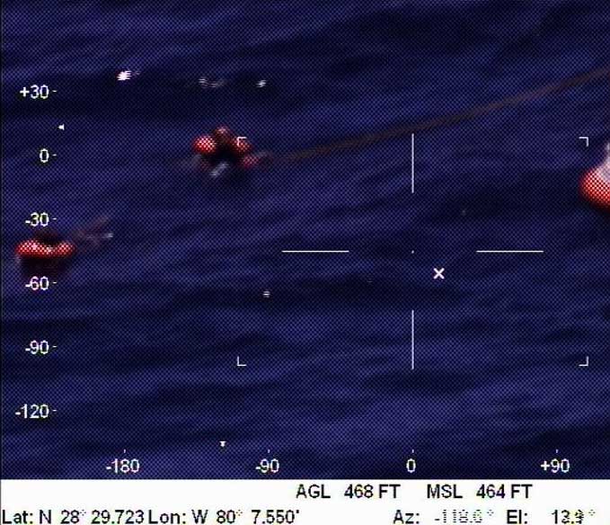

Another image shows the 45-foot Response Boat on scene with the swimmers.
The camera position is
Lat = 28° 29.723' N
Lon = 80° 07.550' W
and the time stamp is 16:31:34L, which perhaps would be 4:31 p.m.
The images were taken from an aircraft overhead and may be long telephoto shots, giving the position of the aircraft. But we can compute the distance between the two locations of the aircraft: 2.63-miles--quite a lot of drift away from the boat.
Since the PLB was apparently with one of the swimmers, the PLB should have been giving the position of the swimmers, not the boat. On the other hand, when the PLB was first activated, it was close to the boat. Again, because this PLB had a GPS receiver, the position of the PLB would be updated by the GPS receiver in the device, presumably in a subsequent transmission. I believe that once the PLB is activated, it transmits continually, so the position would be continually updated. (See more about the position update intervals in a follow-on article, below.)
As for the time, the local time in Florida in May would have been GMT-4 due to Daylight Savings Time being in effect. If the time stamps are interpreted as GMT time, then the local time would have been 12:04 p.m. (boat image) and 12:31 p.m. (swimmer image).
Since the narrative describes the PLB activation as 10:30 a.m. local and the first sighting of the aircraft by the swimmers as about two hours later or about 12:30 p.m., perhaps the time stamps should be interpreted as GMT time. If the time stamps are local time, the swimmers would have been in the water for six hours, which seems unlikely to have produced such a good outcome.

Using the position of the aircraft that took the image of the swimmers, we can find the distance offshore:
--almost 25-miles from nearest land
--almost 29-miles from the Port Canaveral Inlet
The USCG press release says the 45-foot Response Boat departed from Port Canaveral. Assuming the base is within a mile of the inlet, that suggests they had to make a 30-mile run out to sea. The sea state is described as three to four-foot high waves. Wikipedia says the cruising speed of the USCG 45-foot response boat is 35-MPH, and the top speed is 48.9-MPH. it seems reasonable to assume that the USCG 45-footer could have reached the location in an hour, and perhaps less if they ran at their top speed.

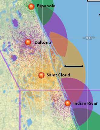

The position of the boat in distress as documented by the aerial photo is roughly
Lat = 28° 27.853' N
Lon = 80° 06.050' W
Now we compare with the RESCUE 21 radio coverage map for that area. Here is a portion of the low-resolution coverage maps provided by the USCG for that area:
I have drawn a black horizontal line from shore using the 20-mile scale of the original image. We see that the coverage contour stops short of longitude 80-W, but does extend beyond the nominal system goal of 20-miles to seaward in that area. That the boat was in a position further than shown in the coverage map--the boat was just west of 80-degrees longitude--does not mean that the boat was necessarily beyond the range of the system. The described contour is for a signal of 1-Watt from an antenna at 6-feet, and for a duration of only 1-second. The narrative describes the boat as making several long transmissions on 156.800-MHz as MAYDAY broadcasts, and communicating with some other (never identified) station. The aerial image shows a boat radio antenna whose base is at least 8-feet above the water, and the transmitter is assumed to be a conventional fixed-mount 25-Watt model. With those parameters, you would expect that RESCUE 21 would have received the broadcast, at least on the installation at SAINT CLOUD. A single radio direction bearing from the SAINT CLOUD facility would not have give a position for the boat, just a bearing line. But the narrative describes the boater passing his position coordinates to another station. Someone had their position.
