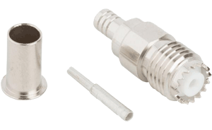

In boating, the DIGITAL brand antennas have begun to use Mini-UHF connectors. The DIGITAL brand antennas often have a Mini-UHF cable end jack crimp connector installed on the antenna transmission line. DIGITAL then supplies an adaptor, a Mini-UHF plug to UHF plug, permitting the antenna transmission line to be connected to the UHF Jack on the radio. The pre-installation of the Mini-UHF jack on the transmission line relieves the boater of the task of installing a connector. The small outside diameter of the Mini-UHF jack connector permits the pre-installed connector and transmission line to be routed through existing conduits and bulkhead openings without having to enlarge the conduit or bulkhead openings much more than would be required for just the RG-58C/U transmission line diameter (nominal OD of 0.2-inch).
Mini-UHF Jack, Cable End, RG-58/U; Amphenol 81-116.
The max OD of the connector is just 0.375-inch.
The Mini-UHF cable end jack connectors are usually crimp-type connectors, so one must have the appropriate crimp tools to properly install them. (More on crimp tools in a future addendum to this thread.)

For comparison an AMPHENOL brand Mini-UHF cable-end jack crimp connector for RG-58/U-size cable is their part number 81-116. MOUSER, a large retail distributor, has the 81-116 connector in stock at $14.33 in single-unit quantities. I don't know why this connector is so much more expensive. It appears to have a smaller overall OD than the 182112 connector, and is only 0.375-inch OD.
