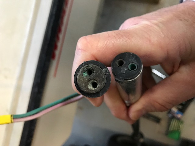

Here is a picture of [the pole base of the aft navigation lamp] as well as the connector:

Postby jimh » Sun Feb 04, 2018 4:55 pm
My interpretation of the image:
--on the left is a cable-end connector with socket contacts coming from a branch circuit that supplies power;
--on the right is a connector integrated into the pole of a pole lamp with socket contacts that is the load for this circuit.
If that is correct, there is no good solution to the situation shown in the image. The pole lamp has a socket connector. You'd need to install a male-gender cable end plug to mate. That would be a bad choice, as it would leave the power on exposed pins.
The actual situation may be: the pole lamp used to have pins or male contacts and they broke away.

Postby Jefecinco » Sun Feb 04, 2018 7:40 pm
Is it possible the pole connector fits into a socket with a male receptacle? If so, it would seem to be a bad idea as pointed out in in jimh's comment. Is there a male socket on your boat. If I remember correctly the white all around light on our 190 Montauk uses a pole with a female connection like yours. It is designed to fit into a socket on top of the helm which has a rubber weather resistant cap over it to protect the male connector from the elements and inadvertent contact.
