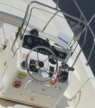

My choice would be a Lowrance HDS-7 Gen3. It should fit nicely in the corner on the console. Here is a picture of an older HDS-5 mounted on my 2005 170 Montauk, the unit is interface with my E-tec via NMEA-2000 and with the VHF via NMEA-0183. I should have went with a 7" unit at that time - but prices where much higher back then. BTW I am also fishing Charlotte Harbor down to Boca Grande. Please post a picture of your boat with the T-top.

Thanks Ridge Runner for the pic showing the HDS5. It's funny you say that about the HDS7 Gen 3, it's exactly what I was hoping to get end of last year but I wasn't ready to buy at the time and now all the distributors I've talked to said they can't get a unit from Lowrance anymore.
