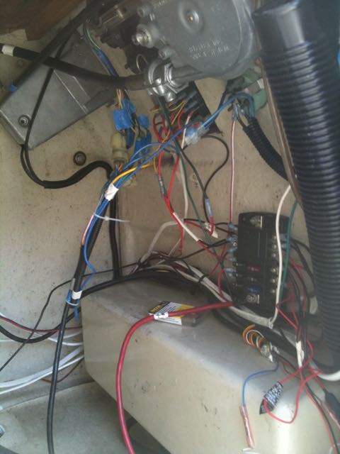

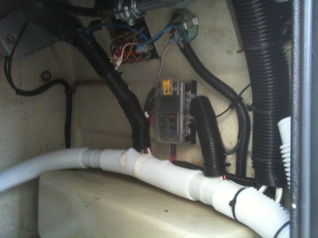

First thing I do is draw a rough diagram of what the wiring is doing. Show colors. Once I understand what needs to be there, you can decide how to improve it, in addition to cleaning it up. You can make a list of all the wire you need by color and gauge, list of terminal rings, connectors, and etc.
Figure out where you want the wiring to go and how it will be protected (wire loom) and attached in the console.

Here are two photos to show how well re-wiring can turn out. The first is after running all the new wiring, adding Bus Bar, battery switch, etc. The second is after it is all bundled up. I wrapped everything in loom or bilge hose since it is in a console that gets items thrown in. Would not want a wire to get loose.
Rough:
Cleaned up and secured:

Postby jimh » Tue Mar 13, 2018 3:23 pm
PHIL--from the image you provide it appears that you are using some sort of split hose as a flexible conduit for electrical cables. I don't endorse that use; the exit of wiring from the conduit will be via the split portion, which would have a risk for abrasion of the wire insulation against the hose material.
