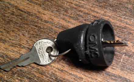

The better outboard engine ignition key switches usually have the actual key mounted in a rubber cap assembly. When the key is inserted into the lock portion of the ignition key switch, the cap assembly covers the opening of the key slot. Check to see if your particular ignition key and switch are available with the key mounted in such a cap or cover assembly. Here is the ignition key for my c.1992 Evinrude engine, nicely mounted in a rubber shroud.
OMC ignition key mounted in rubber shroud to prevent ingress of water into ignition key switch slot
OMC figured this out a long time ago. When their ignition key is installed in this rubber shroud, it is much harder for water to get into the key slot of the ignition key switch. Also, there is a specific orientation for the ignition key switch because there is a drain designed into it to allow any water that does get in there to drain out. The switch has to be properly oriented to allow the water to drain. If you put the switch in upside down, you cancel the draining action.
