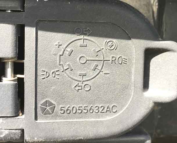

Next I needed to investigate how the new truck’s OEM connector was wired. I sat down behind the rear bumper with my DMM and a sketch from my article’s wiring diagram of the connector, and I was about to start testing. Then I saw the flip-up cover of the connector was embossed with a wiring diagram.
Fig. 1. The truck manufacturer (Jeep) had very nicely provided a pictorial diagram of the wiring it used for the 7-pole trailer connector cover.
The inclusion by the truck manufacturer of a schematic diagram of the truck’s trailer connector was a great help. I quickly verified the wiring and reconciled it against my trailer wiring: the two were a match.

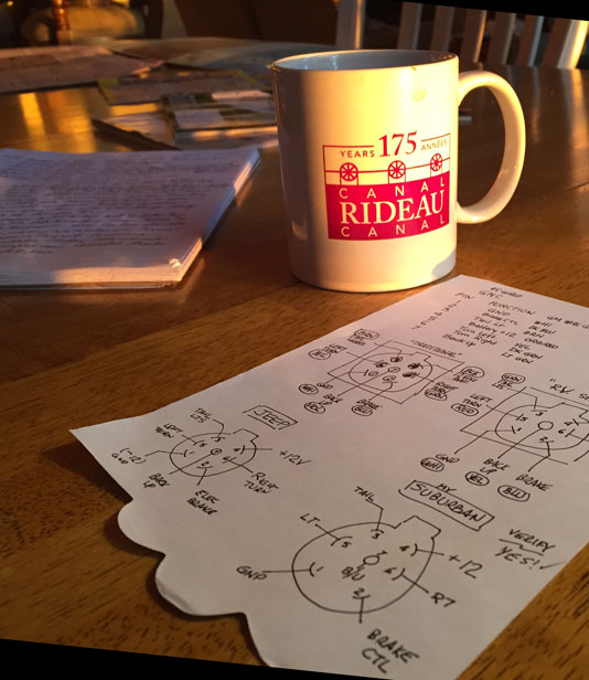

Fig. 2. To work out the wiring and compare the two connectors, I needed some early morning sunlight and some good coffee.
At this point I was confident that my trailer could be connected to the new truck, and all circuits would work. The point of all this pre-testing was to avoid having a fuse in the truck blow—or something even worse happen—if my trailer (and my other truck) turned out to be (mutually) wired incorrectly for all these years.
After about an hour of time spent testing and checking, I finally connected my trailer 7-pole plug to the new truck’s OEM 7-pole receptacle: all circuits worked properly and no fuses blew.
