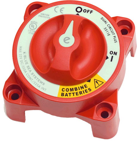

The traditional boat battery switch for two batteries was a single-pole four-position switch with positions OFF-1-BOTH-2. The Blue Sea Systems company has a new line of battery switches which are two-pole three-position switches with positions OFF-ON-COMBINE.
Blue Sea Systems Dual-circuit Battery Switch Model 5511e
The dual-circuit or two-pole switches are intended for boat electrical systems in which there is an engine cranking battery and an isolated and separate house load battery, and in normal operation the two systems are never tied together. The dual circuit battery switch controls both with a single switch while keeping them isolated.
The isolation of the two circuits means there has to be some method of charging the house battery that is distinct from charging the cranking battery, such as a second alternator charging output from the outboard engine. Several outboard engine brands offer the option of adding a second charging output to their engine, which is then connected to the house battery.
If an outboard engine is used that does not have a second charging output, then the house battery is typically charged by the connecting it in parallel with the cranking battery, but only after the cranking battery terminal voltage has risen high enough to indicate the cranking battery is near to or at full-charge level. The COMBINE position is not intended for normal operation of the system, as it parallels the two batteries and mixes the cranking and house loads together, although it could be used that way to share charging current.
Instead of manually setting the switch to COMBINE, a more convenient and automatic method of accomplishing the charging of the isolated second battery or house battery is to use a voltage sensitive relay (VSR) which will close and parallel the two batteries when the terminal voltage of the cranking battery exceeds a certain threshold. These relays are also called an automatic combiner relay or automatic charging relay or ACR. In well-designed ACR devices the closing of the relay is delayed until certain criteria in addition to just voltage are met, such as a minimum amount of time at a certain voltage before closing, or a minimum about of time being open before closing again, or the absence of an external signal that is applied to prevent closing, as, for example, when the ignition key is in the START position. But these considerations are all in the ACR, not in the battery switch itself.
The Blue Sea Systems newer two-pole or dual-circuit switches come in two sizes, regular and mini. If you are replacing a traditional battery switch, the Blue Sea Systems 5511e-series will very likely have the same layout of mounting holes as the original switch being replaced. This can be convenient, particularly if the original switch was through-bolted to a bulkhead. The 6011-series smaller switch will need new mounting hole locations due to its compact size. The ratings are slightly different for electrical capacity:

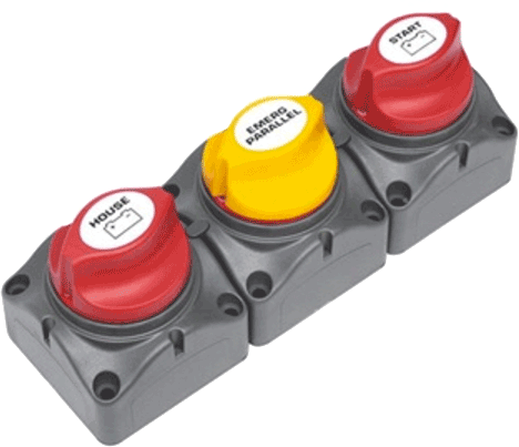

When three switches are combined into a cluster, it available as the Model 715 Battery Distribution Cluster and looks like this:
BEP Battery Switch Cluster for two batteries
BEP began in New Zealand, and in 2006 became part of the POWER PRODUCTS LLC conglomerate of marine electrical component companies.
Re: Dual-Circuit Battery Switches
Postby jimh » Thu Sep 07, 2017 10:10 am
Comparing the two types of dual-circuit battery switches, the three-switch cluster from BEP offers the user more flexibility than the single switch from Blue Sea Systems. On the other hand, operation of the BEP cluster is a bit more complicated.
With the Blue Sea System dual-circuit switch, both the cranking circuit and the house circuit are energized in the ON position, and the two are combined in the COMBINE position. With the BEP three-switch cluster, you can separately energize the START circuit and the HOUSE circuit, if you desire.
In the standard configuration of the BEP cluster, the EMERG PARALLEL switch is on the battery side of the circuit. That means if the EMERG PARALLEL switch is set to ON and, for example, on the START circuit is set to ON, then the two batteries are combined in parallel and energize only the engine START circuit; the HOUSE circuit remains OFF.
The BEP cluster could be modified so the EMERG PARALLEL switch is on the load side of the circuit. That means you could use one battery to power both the START and the HOUSE circuits, and leave the other battery disconnected. That arrangement might be useful in a situation where one of the batteries failed with a shorted cell.
Keeping track of the position of three switches and what circuits are energized will be more difficult than keeping track of the simpler ON-OFF action of a single switch. Sometimes more options (more complexity) is useful, but sometimes it can get in the way.
