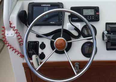

Nice! I like that better than the one I installed:
That way, I could differentiate between the USB charger and the cigar lighter!
