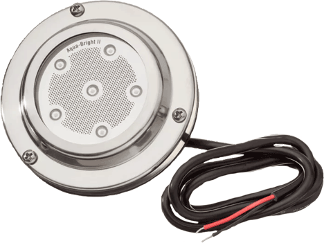

I recently completed a project to add LED underwater lamps to the transom of my 20-foot Boston Whaler boat. The LED underwater lamps really light up the water. I bought the LED underwater lamps from Bass Pro Shops. If interested in the source see:
https://www.basspro.com/shop/en/bass-pro-shops-led-high-output-underwater-light
Fig. 1. Round LED underwater lamp as sold at Bass Pro Shop for about $60.

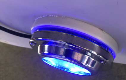

Most [power wiring for LED underwater lamps is intended] to be [routed through the] hull or transom. [Because the hull of my boat is a Boston Whaler Unibond hull], I made the custom mounts using KING StarBoard. To accommodate the the power wire exiting from the base of each lamp, a groove [cut into the mounting base] provides a path for the wiring to exit; without the groove recess the lamps could not mount flush to the transom.
Fig. 2. Custom mount with relief groove to permit power wiring to exit.

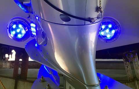

Fig. 3. The power wiring was oriented to exit toward the engine, and the wiring was run within the engine mount upward and over the transom, then through a rigging tunnel to the helm console.

Fig. 5. View of the LED underwater lamps from astern.
