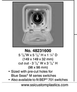

There are several brands of OFF-1-2-Both switch that do not take up much space.
For the Outrage console you could mount one inside the door for easy access or in a recessed pocket in the side near the fire extinguisher, using something like this with a BEP 701 switch:
Screen Shot 2022-02-20 at 4.12.40 PM.png (50.52 KiB) Viewed 16641 times
This dual switch can be installed as a panel mount. Only the turn knob will be on the outside.
https://www.wholesalemarine.com/bep-701 ... or-switch/
I used this switch on both of my Outrage 17's in the glove box.
