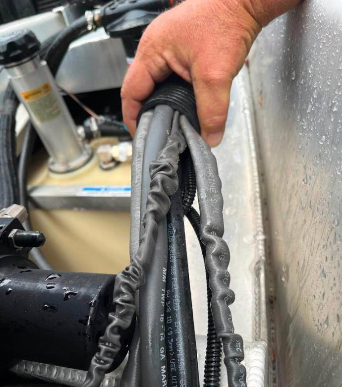

As I was attempting to pull through new [battery cables] into the flexible rigging tube [that carries all the cables and hoses to to the engine cowling fitting], but nothing would budge. Eventually I determined the the fuel hose (that was also in the flexible rigging tube] had a pin-hole leak that had been spraying fuel, albeit a small amount, on all of the other cables in the flexible rigging tube. (See Figure 1, below.)
Fig. 1. The engine rigging tube in which fuel had been spraying from a leak in the fuel hose.
Every cable in the rigging tube experienced some level of degradation as the tube had no weep holes-- a bad design.
After replacing all the cables and hoses, including a new fuel hose, the engine now starts and runs like a champ. Also, I also replaced the solid rigging tube with a mesh version.
Many thanks to all for the help in finding the cause of this problem.

Thanks for the follow-up giving us the cause and the remedy for the problem of poor engine cranking. Your illustration in Figure 1 is also very nice.
Judging from Figure 1, the inside diameter of the flexible tubing that carried the battery cables, fuel hoses, and other cables was rather undersized, as the closed-wall flexible tube looks like it was crammed full of too many hoses and cables. The cables were probably abrading against each other or against the inside wall of the flexible tubing, which may have been the cause of the pin-hole fuel leak.
Unless the gasoline fuel leaking out in the flexible rigging tube was being completely absorbed by the insulation material on the other cables, I would have thought the fuel would have been slowing running back down the flexible tubing and collecting in the boat. Generally gasoline has a quite noticeable odor, and I would have expected that you could smell the presence of the leak.
Also, I expect the engine fuel efficiency will improve not that fuel is not being lost, which is another benefit from fixing the original problem.
Good outcome for both the battery problem and possible future problems as the other cables began to decay more.
