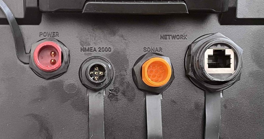

Figure 1. Back panel of Garmin ECHOMAP UHD2 93sv.Note that there is a connection for NMEA 2000, but not NMEA 0183 – that feature was dropped when the unit was updated from the UHD to the UHD2 model.
ECHOMAP UHD2 connections low res.jpg (105.86 KiB) Viewed 4851 times

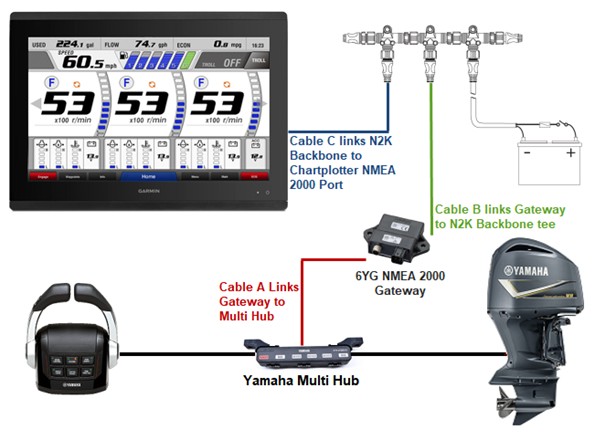

Option 1. Base Yamaha Support via Gateway - NMEA 2000 Integration Only
The diagram below is taken from the online Garmin Support Center article entitled “Supported Yamaha Features on a Garmin® Chartplotter” (available at https://support.garmin.com/en-US/?faq=0 ... U4vCHDgiA6). It shows a Yamaha Multi Hub connected to a Yamaha gateway that converts Yamaha information which can then be provided to the Garmin system via an NMEA 2000 bus. The Garmin article says “this installation provides engine data (Speed, Oil Pressure, etc.) and a Yamaha-specific User Interface”. Although documentation on the gateway is sparse, it appears that it translates some proprietary NMEA 2000 codes coming from the engine’s ECU so that they can be displayed by the Garmin MFD in a way that emulates a Yamaha CL7 screen. (The CL7 is an MFD manufactured by Garmin that is branded and sold by Yamaha.) If I had brought my boat to a Yamaha dealer with an ECHOMAP UHD2 93sv in hand and asked to have it connected to the engine, this is what I probably would have been offered. There is a Yamaha Multi Hub, which is Yamaha’s proprietary version of an NMEA 2000 bus, connected to a Yamaha NMEA 2000 gateway, which feeds into a generic NMEA 2000 bus that connects to the Garmin MFD. This setup would permit the use of Yamaha gauges or displays by connecting them to the Multi Hub while still allowing engine data to be transmitted to and displayed by the Garmin unit via the (generic) NMEA 2000 bus.
Figure 2. ECHOMAP connections to NMEA 2000 bus.
ECHOMAP NMEA 2000 bus.jpg (56.47 KiB) Viewed 4851 times
This diagram isn’t very realistic – note that a single engine is depicted, but the control shown is for two engines, and the MFD is displaying data for three engines. The throttle appears to be connected to the multi hub (which it is not, unless the throttle also contains an ignition key). Below is a diagram taken from a Yamaha Dealer Rigging Guide dated 2021 which shows the wiring between the gateway and the engine.

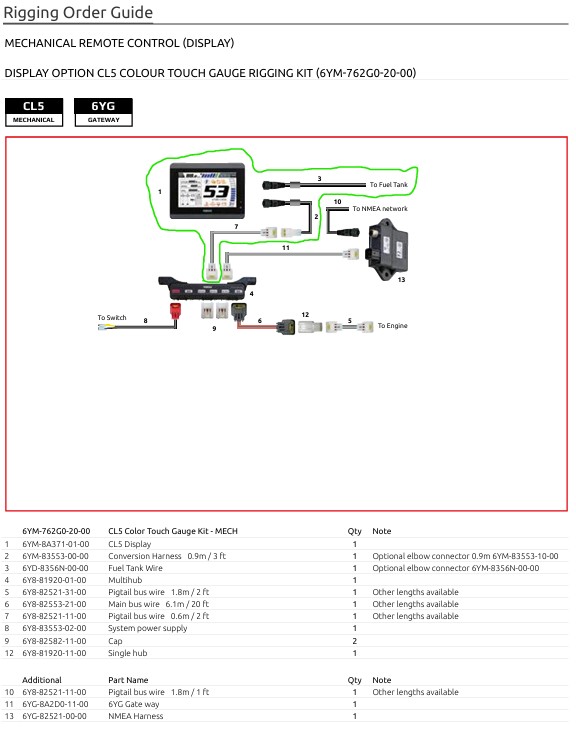

Figure 3. Connecting a Yamaha engine to an NMEA 2000 bus via a Yamaha Multi Hub and Gateway.
Yamaha gateway bus 1.jpg (74.07 KiB) Viewed 4851 times
This Yamaha diagram shows the connections between the gateway and the engine in greater detail than in the diagram supplied by Garmin. A Yamaha CL5 display (which I have circled in green) is shown connected to the Multi Hub, but for the purposes of this discussion it can be ignored. One might infer that these two diagrams could suffice as a guide for connecting the Garmin MFD to a Yamaha engine, but there are some problems here. Items 10, 11, and 13 are mislabeled, and there is an extra cap (item 9), but more importantly, power is being supplied at two different locations; if the power sources are not electrically isolated, they could cause devices attached to the buses to malfunction. It would make sense for Yamaha to include a power isolator in their gateway, but I have never seen this documented, so in this case a power isolator (not shown) should be installed between the two buses. Recall also that terminating resistors are required on the ends of an NMEA 2000 bus, whether it is generic or proprietary like the Yamaha Multi Hub. In these diagrams, the generic NMEA 2000 bus has terminators, but they appear to be missing from the Multi Hub. (Actually, only one resistor is missing, as there is a resistor incorporated into item 12, the single hub assembly.)

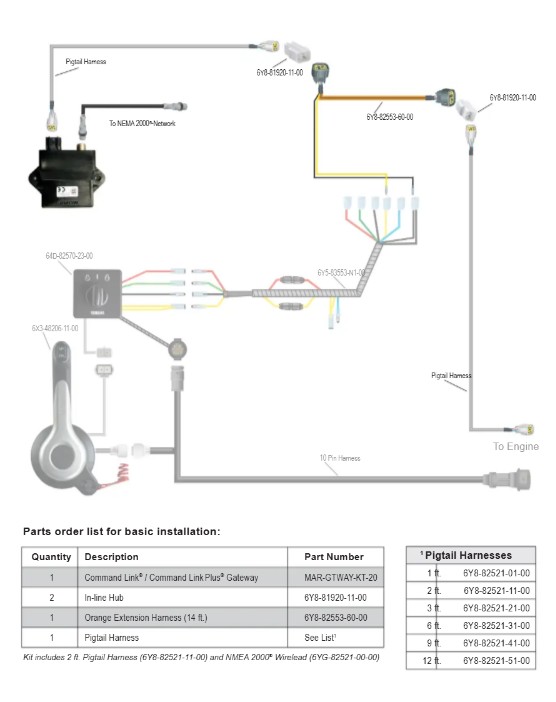

Option 2. NMEA 2000 using Yamaha gateway without the Multi Hub
For installations that don’t require a Multi Hub, Yamaha provides cables and adapters for connecting the gateway directly to the engine, as shown in the diagram below (downloaded from https://static.perfprotech.com/files/st ... ltihub.pdf) Note that some of the NMEA bus architecture (terminating resistors, switched power supply) is maintained.
Figure 4. Configuring the Yamaha gateway for NMEA 2000 data without using a Yamaha Multi Hub.
Yamaha gateway bus 2.jpg (51.64 KiB) Viewed 4846 times

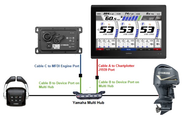

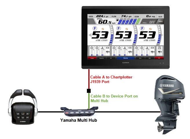

Option 5: “Full Yamaha® Support - J1939 Integration with MFD Interface”.
This configuration comprises a Yamaha Multi Hub that is connected via a J1939 cable to a Garmin GPSMAP as well as to a Yamaha MFD Interface (MFDI) black box that provides the following: Engine data (Speed, Oil Pressure, etc.); Yamaha-specific User Interface; Autopilot Controls (e.g. Heading Hold, Pattern Steer, etc.); Engine and Peripherals Control (Steering Friction, Trim, etc.); Technician Settings; and Send Waypoint data over J1939 to a Garmin MFD.
Figure 6. Yamaha data via MFD interface
GPSMAP J1939 connection 1.jpg (46.6 KiB) Viewed 4825 times
I believe this setup is meant to allow boat builders to install large glass MFDs which emulate the functionality of the Yamaha CL7 display. The MFD Interface (Type 1) is designed to work only with Garmin MFDs. Yamaha markets a similar unit (Type 2) which can be used with some other MFD brands.

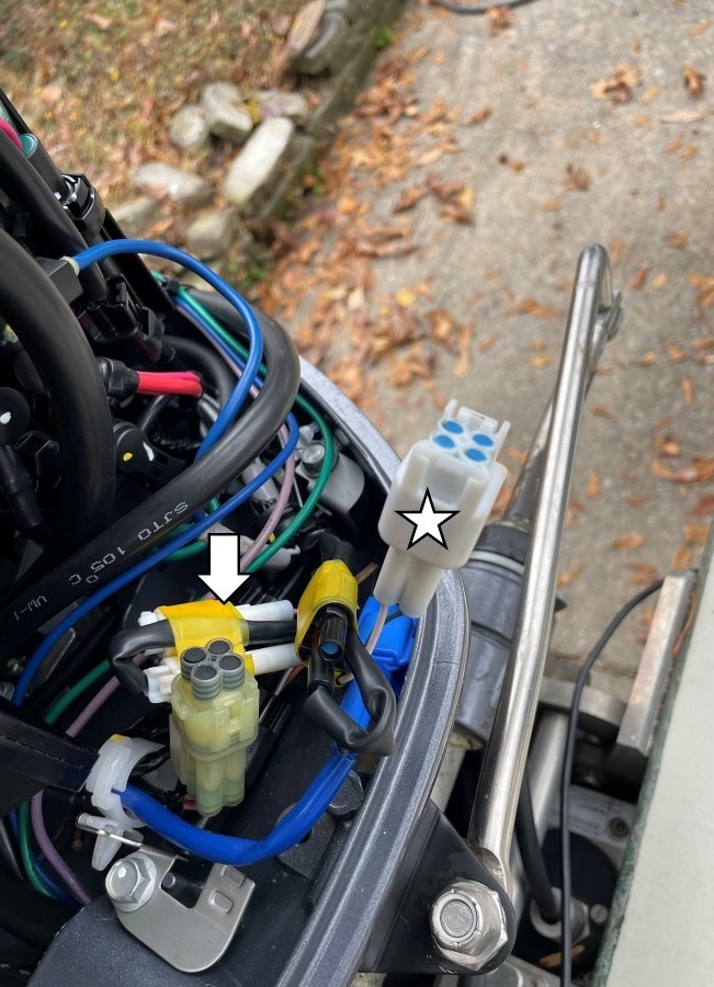

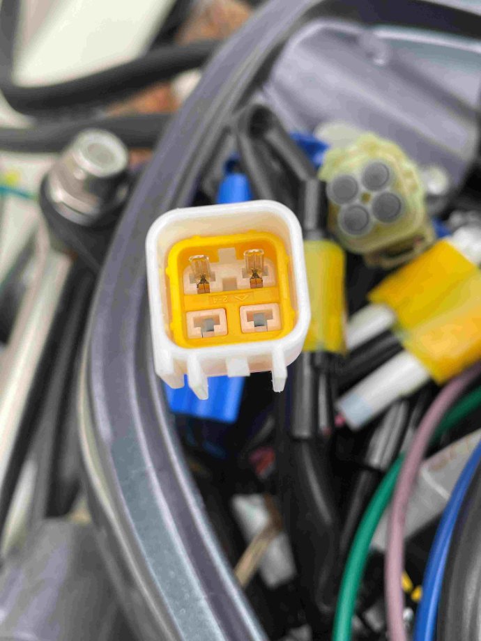

The installation is straightforward – connect one end of the interface cable to the Furukawa plug (the one with a blue and white wire) under the cowling, and other end to the NMEA 2000 backbone. Watch this YouTube video if you need more guidance doing this (https://www.youtube.com/watch?v=p5s_UUQRMsA). The hardest part for me was fitting the cable through the rigging grommet because I already had two cables from the hydraulic jack plate running through it. Here are pictures of the pertinent engine plugs:
Figure 7. Yamaha F70 NMEA 2000 plug (star), and trim plug (arrow). The NMEA plug protector must be removed to connect the interface cable. The tape and plug protectors should be removed from the trim plug and the two connectors joined to allow trim data to be displayed on the MFD.
Yamaha NMEA and trim plugs low res.jpg (237.79 KiB) Viewed 4801 times
Figure 8. Yamaha NMEA 2000 Furukawa plug. Note that only two of the four pin positions are used. The white trim plugs with yellow tape are in the background.
Yamaha NMEA plug low res.jpg (88.85 KiB) Viewed 4801 times

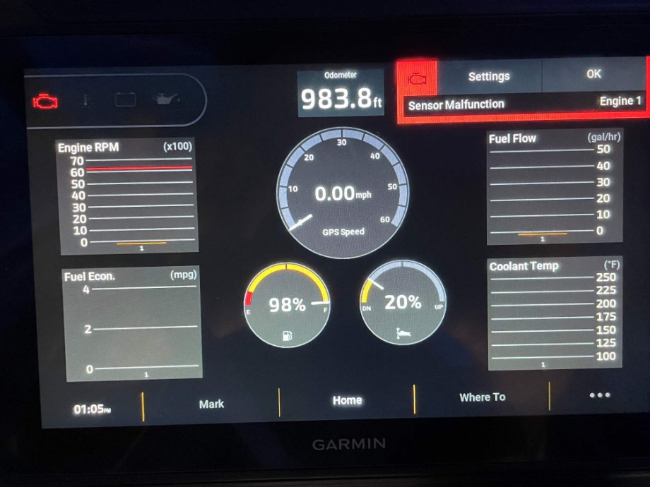

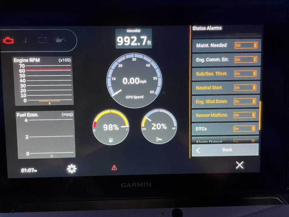

After connecting and initializing the Garmin Echomap, I powered up the NMEA 2000 backbone and turned the engine's ignition switch only to be greeted with a loud beeping and an error code displayed on the MFD.
Figure 9. Initial engine display.
Garmin Echomap initial picture.jpg (81 KiB) Viewed 4800 times
Actually, there were four alarms activated, as seen here.
Figure 10, Garmin status alarms activated on initial start-up are highlighted in orange.
Garmin Echomap status alarms.jpg (78.45 KiB) Viewed 4800 times
This was not unexpected; Garmin units are known to interpret some proprietary Yamaha codes as alarms. To clear these, one must tap on the three dots at the lower right of the home screen, then tap on Status Alarms -->Custom, and scroll down to the activated alarms, which will be highlighted in orange. Toggle each alarm to "off", and then exit. After that, the MFD displayed all the data as expected. Here is the screen I settled on for now, although I will probably modify this in the future with further use. I am satisfied with the outcome of this installation.

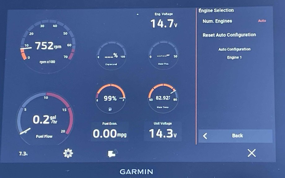

Figure 11. Final MFD engine screen.
Garmin Echomap final picture.jpg (75.83 KiB) Viewed 4800 times

Thank you for the very interesting series of articles on the Yamaha to NMEA-2000 interface options.
I notice that in the network connection point there are only two wires, which must then be the data circuit. This means the network power circuit is not connected to the Yamaha devices.
Generally in NMEA-2000 the network power circuit is continued to and connected to any devices on the network, in order that the network interface device will be operating from network power. And in the case of some headless small devices (such as a fuel manager or an interface convertor) the attached device will operate from network power, as typically those small devices have no other power connection provided.
The NMEA-2000 network electrical protocol is derived from the CANBus protocol. The CANBus protocol requires that each network device use an isolated power connection to the network in order to avoid introducing ground loops into the bus power. There is a technical discussion of the CAN interface as used in NMEA-2000 at
https://ttlappalainen.github.io/NMEA200 ... et_up.html
Without knowing exactly how Yamaha has implemented their NMEA-2000 interface, it will not be possible to understand if their device follows the protocol for maintaining power isolation or now. On the basis that it works and does not actually make an electrical connection to the network bus power circuit, one can presume it is operating in accordance with the NMEA-2000 protocol--but it still seems to be an outlier in terms of most other NMEA-2000 devices where the power circuit is carried to the device at the point of connection to the network backbone bus.

A final note about connecting a Garmin ECHOMAP UHD2 93sv to a Yamaha F70 outboard motor:
The setup for the Garmin unit includes designating the number of engines, and I initially chose “1”. When I ran the boat, the fuel economy readout was blank, but when I reset the number of engines to “Auto Configure”, fuel economy was displayed. I have since had to punch the “Reset Auto Configuration” option on the Engine Selection menu to get the data to reappear after the boat sat idle for a day.
Figure 11. “Auto Configure” may need to be selected for fuel economy data to appear.
ECHOMAP setup 1 June 2026.jpg (61.67 KiB) Viewed 1797 times

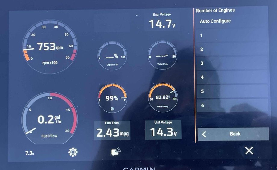

Figure 12. If Auto Configure has been previously selected but the fuel economy data has disappeared, selecting “Reset Auto Configuration” may cause it to reappear.
ECHOMAP setup 2 June 2026.jpg (59.24 KiB) Viewed 1797 times
