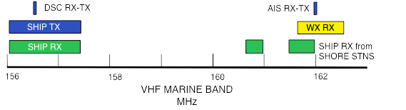

The VHF Marine Band is represented graphically below, with annotations of where the various ship station transmitter and receiver frequencies are located:
VHF Marine Band Spectrum
As you can see, the portion of the VHF Marine Band in which a ship station will transmit is very narrow, confined to the lower portion of the band. The only exception to this occurs with an automatic identification system (AIS) transponder, which will transmit at the very high end of the marine band. This graphic representation should help readers understand the need for a specialized antenna for AIS transponder transmitters.
Note also that the NOAA Weather Radio band extends farther than the AIS frequencies, and for decades no one ever suggested that a wide-band antenna was necessary to properly receive weather radio broadcasts. Also note that shore stations in the public service using duplex transmit-receive are being received by the ship at the very high end of the band, too. Again, no one ever suggested that in order to communicate with a duplex shore station you should have a wide-band antenna to improve reception.
