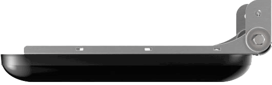

NAVICO, the parent of Lowrance and Simrad, have announced a new SONAR transducer they are calling the TotalScan transducer. They describe this transducer as an "all-in-one transducer that matches [their brand of frequency modulated pulse compression] SONAR with StructureScanHD and DownScan Imaging technology."
Navico TotalScan Transducer
The TotalScan transducer will utilize a new 9-pin black connector called the xSonic connector. To fit the TotalScan xSonic connector to legacy SONAR products using the 7-pin blue connector, an adaptor cable will be necessary. Unfortunately, when used with the adaptor cable, the side scanning function will be lost.

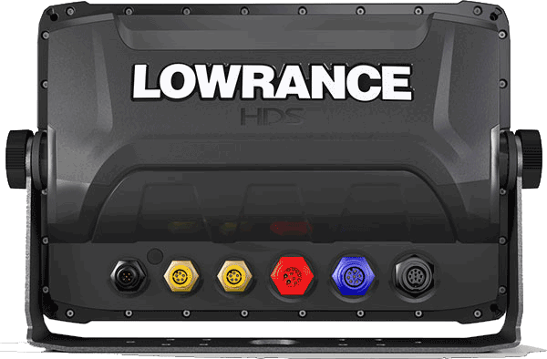

HDS-12 Gen3 Rear Panel
Lowrance HDS-12 Gen3 Rear Panel showing black 9-pin transducer connector now called the xSonic connector
When the new TotalScan transducer is connected at this 9-pin transducer connector, it can be used for all three applications, that is, frequency modulated pulse compression (or CHIRP), side scanning (or StructureScan HD) or conventional downward directed SONAR with higher frequencies (or DownScan Imaging). Having all three functions in one transducer will be an attractive option to replace using two or three separate transducers.

Lowrance now has a webpage for the TotalScan Skimmer transducer with 83/200/455/800kHz, Medium/High CHIRP elements. The MSRP is $300. They also have published the installation manual.

jimh wrote:Lowrance now has a webpage for the TotalScan Skimmer transducer with 83/200/455/800kHz, Medium/High CHIRP elements. The MSRP is $300. They also have published the installation manual.
It appears that the above linked page is now at
http://www.lowrance.com/en-US/Products/ ... en-us.aspx
And the installation manual linked above and on the web appear to be for the older transducer, at least the pictures referenced in the manual are the previous version.
[NOTE: I fixed the broken link where it appeared above. I guess Lowrance's website changes navigation on a weekly basis. In technical manual writing, a lot of boiler-plate is used, so it is not unheard of that a previous illustration to show placement might be reused, even though the appearance of the transducer might not correspond--jimh]

The TotalScan transducer cable is terminated in a 9-pin connector, now called the xSonic connector, and the HDS has a mating connector, called the "Structure Scan" connector.

Looks like [NAVICO] updated the TotalScan transducer's mount to plastic with ratcheting locking teeth adjustment.
