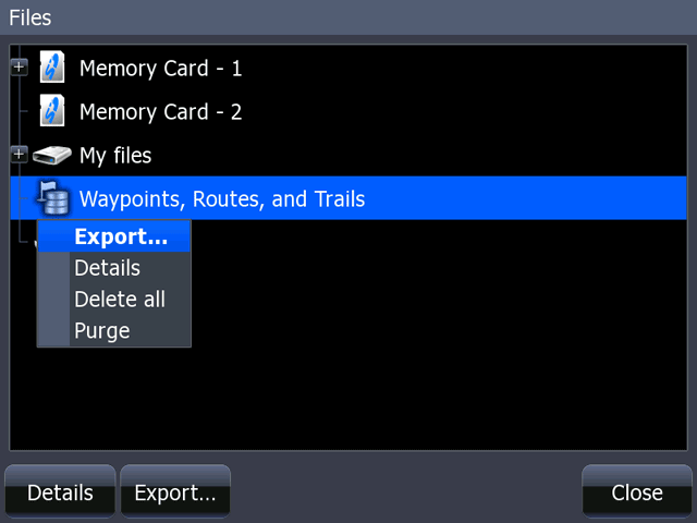

Then I deleted the waypoints, routes, and trails from the HDS. This can be done from the FILES page. You have to hit the MENU button to invoke all the menu options. Unless you do this, there are only two options shown (Export and Details). When you push the MENU button, two more options appear (Delete All and Purge).

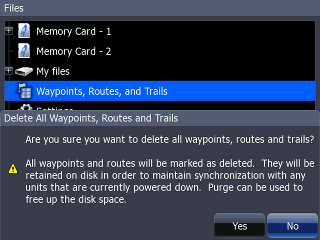

To delete all the waypoints, routes, and trails, select that option and hit the ENTER button. A warning screen pops up to verify this action is really to be performed:

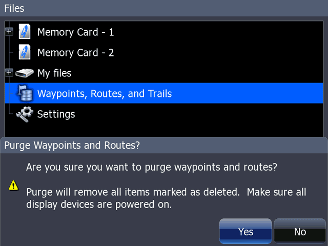

To continue with the deletion of the waypoints, hit the YES softkey. After deleting all the waypoints, routes, and trails, these files are not really removed. They are kept on the internal memory of the HDS because they may be the source of data on other connected devices that are synchronizing to this HDS. To get rid of these file permanently, you have to use the Purge option. This actually will remove the files from the HDS memory, freeing up space.
Again, the Delete All and Purge options are found by pushing the MENU button when on the FILES page. It is not particularly intuitive that those options are there.
