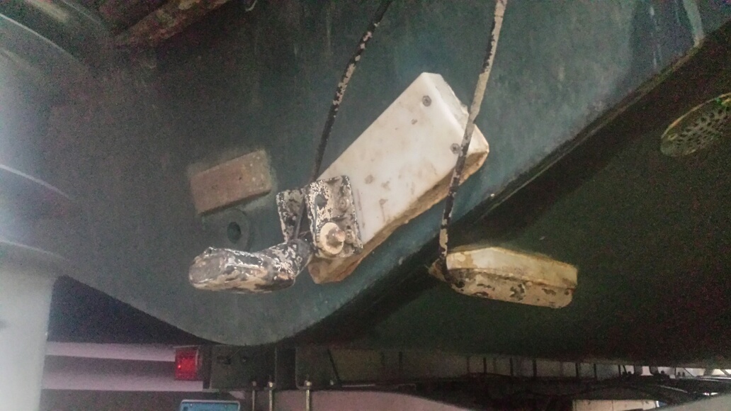

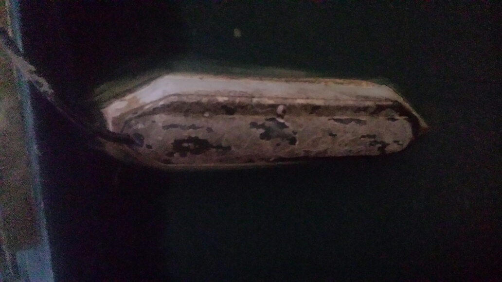

Acseatsri wrote:I have one mounted on my 23 Walkaround. It was originally transom-mounted, but in that position it would only see the side opposite the lower unit. I ended up making a 20 degree fairing block and mounting it directly on the bottom of the boat. It now sees both sides of the bottom contour equally well. It works particularly well looking for rockpiles when black fishing, but I haven't found the sidescan particularly useful for most saltwater fishing. I'm glad I got the transducer for free, as it wouldn't have been worth the $300 cost.
Have any pictures of what you did?
Did you notice any performance differences with the change, such as listing at speed?
I have yet to water test mine. My boat is a 21' hull with trim tabs. Because of the tabs both transducers are currently mounted in the same relative position from port to starboard. Because of the length of the LSS2 there is little room for mounting options once the outboard is trimmed all the way in. I can move it towards the center a bit, but for now it was installed on an existing Stern Saver block.
I am tempted with the idea of making a fairing block and mounting it on the bottom. Something along the lines of a homemade Stern Saver.

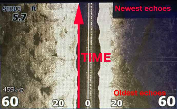

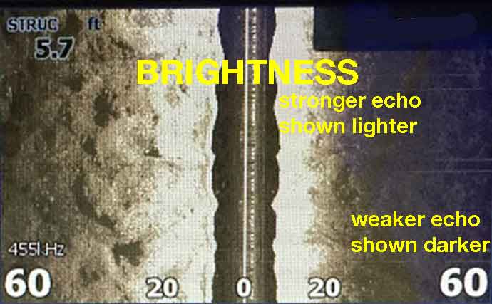

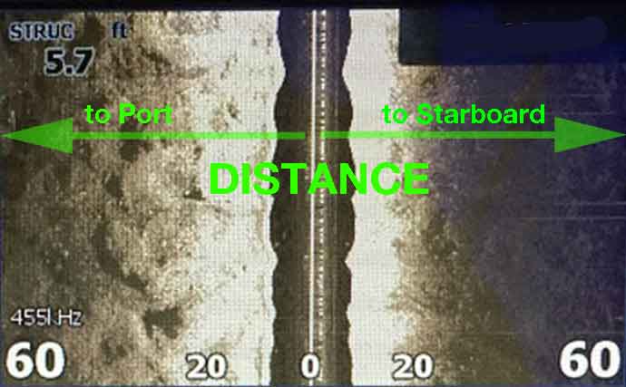

Postby porthole » Sun Nov 29, 2015 12:34 pm
Photograph of display screen with only the Airmar [model TM 150 transducer] active
Both active. [Notice palette color shift in left side sonogram.]

Postby jimh » Sun Nov 29, 2015 12:55 pm
If you are in only 5.7-feet of water I would not expect the range of the side scan to go very far. Isn't the range of the side scan SONAR related to the water depth?
ASIDE: You should be able to get a much better image of the screen by using the built-in screen capture utility.

Postby porthole » Sun Nov 29, 2015 9:44 pm
jimh wrote:If you are in only 5.7-feet of water I would not expect the range of the side scan to go very far. Isn't the range of the side scan SONAR related to the water depth?
The side scan, according to Lowrance is a 180 degree view left to right and only a couple of degrees front to back (4-6 degrees I think).
Although I did not receive information as to how far out it will return pings horizontally.
I can only assume that the top right SONAR return in this picture is indeed looking out 60 feet in the water that is about 8' deep. Using the sand ripples as a gauge.
The left side scan is shooting out towards the center of the river, which is only a few feet deeper (this was near dead low tide).
The right side scan is probably 50-70 feet from the waters edge, so from the boat out to the right it gets shallow quickly. That might explain why the return looks different form side to side.

My transducers. Port side is the LSS-2, Airmar TM150 on the starboard. Hard to tell, but the LSS-2 is slightly below the height of the TM150.
The blue tape and mark is how far toward the center I can go without hitting the lower unit on turns. So I could get it a couple inches lower. Since it is a low speed device I'm guessing the prop will not interfere to much.
As far as quality of side scans go, I would hope to be able to achieve results like this (taken from the Lowrance facebook page)

I snapped a couple pictures of the transducers. Wires aren't secured because I'm doing some work in the area.
As far as any adverse effects from the boat bottom mounted transducer, there is no noticeable difference in the running characteristics of the boat. The fairing block is a 1" thick piece of HDPE with a 20 degree angle cut on the bottom to match the deadrise of the boat bottom and tapers down to about 1/16" thick at the thin side.

It is screwed to the hull using #6 stainless flathead screws, using 5200 to seal it. Holes were not drilled thru the fiberglass and into the foam. To get holes the right depth and the screws the right length took several tries. The holes are drilled only 3/8-inch deep.
Another note: if you use high-density polyethylene (HDPE) for the fairing block, be sure to cut some dovetail slots (or shallow holes that are bigger at the bottom than the top of the hole) in the bottom of the block so the 5200 can fill and allow a mechanical bond to the HDPE. A dovetail slot is smaller at the surface than it is as you go deeper and is the same principle as a Stern Saver.
The transducers are spray painted with a special anti fouling paint specifically for transducers.

I don't see any information in any of the sonograms that tells you how deep the water is in the side scan images. The side scan panel has three axis of information : top-to-bottom axis of image, left-right axis of image, and Z-axis or pixel intensity. These are illustrated below:
The oldest echoes scroll off the display at the bottom, and the newest echoes come on display at the top. This axis maps the history of echoes.
The time between transmission and reception of echoes is proportional to the distance to the reflector. This is presented for two transducers, one facing to Starboard and one facing to Port. Starting from the center line, the echoes are farther to Port or farther to Starboard of the boat. This axis maps the distance of echoes. The graduations, zero in the center and 60 at each corner, represent the calculated distance away (in feet) based on the interval between sending the signal and getting a reflection from a target. For targets close to the boat, the distance is mostly downward, and for targets farther away, the distance begins to become an angle increasing from straight below the boat to straight out to the side.
The strength of the echo is represented by the brightness of the pixel; stronger echoes are drawn with brighter pixels. No echoes are drawn with black pixels. This axis maps the strength of echoes.
Where is the water depth shown?

I am traveling west on Shark River between two bascule bridges. The river in this section is not buoyed, but does have a commonly traveled safe navigation area.
The boat is about in the center of the deepest part, 14' and the shoreline, 1-2' above sea level. I am probably less the 75-100' from either extreme.
Since the boat is traveling across a sloped area, it can be seen on the side scan image.
Looking at the image, "0" representing the centerline of the transducer, the dark area between that centerline and the beginning of the bottom side scan returns on either side is the water column. The sonar is returning a depth of 5.7' under the transducer.
If you look closely at the image you can see the the water column to starboard is slightly shallower then to port.
The display is not showing a digital depth reading on either side, only the current depth under the transducer which is an average of the cones coverage area.
