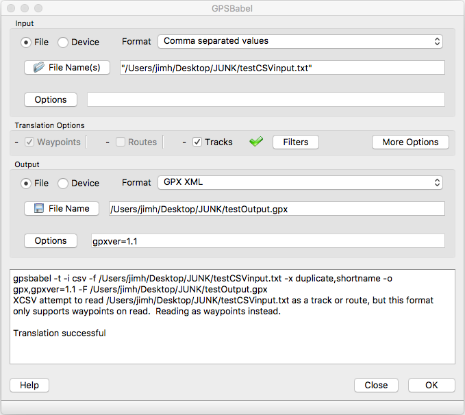

Then I used GPSBabel to create a .GPX file. I selected the input file format to be "Comma separated values" and pointed to the test file. Then I selected the output format to be GPX XML and pointed to a directory for the output file to be created and specified the file name. Then I clicked "OK". Here is the application GPSBabel just after it converted the file:
Note that you don't type all that text into the lower text window; that window is filled by the output of the application as it runs. (The real application is not a graphical user interface, but the MacOS and Windows versions have a graphical user interface to simplify running the program.) You should select the input option TRACKS, even though you will be importing waypoints. If you don't the conversion fails.

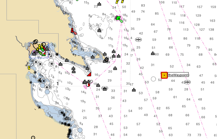

As a final test, I imported the .GPX file into my chartplotter (PolarView NS); the chartplotter read the file and plotted the waypoint with no complaints. This demonstrates end-to-end creation-of-text-file to plotted-on-chartplotter functionality.
Waypoint plotted in chartplotter application POLARVIEW NS
