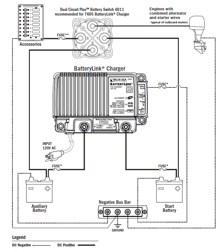

I like the concept of integrating the battery charger and the combiner relay, as the amount of primary power distribution wiring should be reduced significantly compared to wiring a separate charger and ACR into the circuit. The proposed schematic diagram is shown below. [Note: this circuit diagram has since been revised; see second article below]
One curious aspect of the suggested circuit is the fusing of the battery positive lead to the main power switch. Typically that is not done because the current in that branch of the circuit could be several hundred amperes during engine cranking. The fuses for currents of several hundred amperes are disproportionately expensive compared to the other components in the circuit.

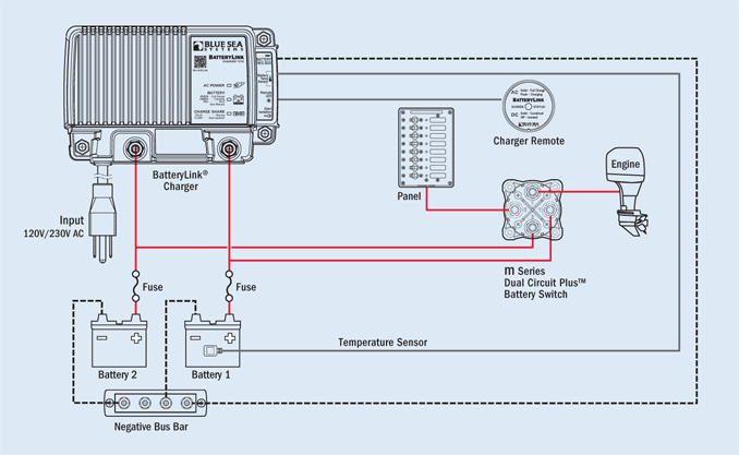

Blue Sea Systems has published more information about their 7605 Charger-Combiner product since my initial comments above. The user manual now clarifies the charging profile used: "The BatteryLink® Charger uses a three stage automatic charging profile. The three stages are referred to as bulk, absorption, and rest/float."
Blue Sea Systems has also revised the wiring diagram supplied with the 7605, relocating the fuses which seemed to be in the wrong place in their earlier diagram; the fuses are now only in the circuit between the batteries and the charger, not in the circuit between the batteries and the engine. Here is the corrected wiring diagram:

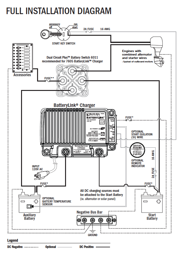

The 7605 also has the nice feature called Start Isolation; this prevents combining of the Cranking battery and House battery during engine starting by the ACR. This prevents a voltage sag on the House battery. Avoiding a voltage sag on the House battery prevents all the electronic devices powered by the House battery from rebooting when the voltage sags. I would certainly install the optional Start Isolation circuit if I installed the 7605. Here is the complete wiring diagram with options shown:
