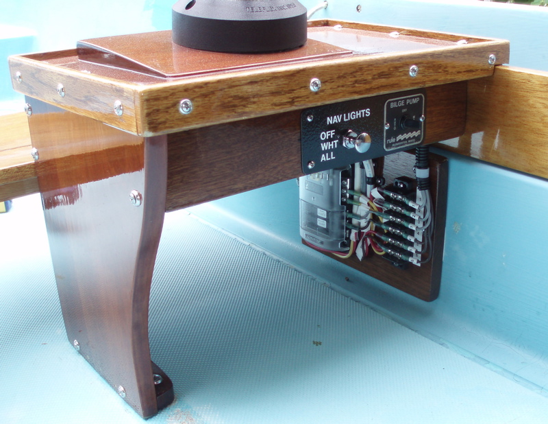

I did similar with my 1966 13-foot Sport, mounting the fuse panel under the console. It's absurdly over-engineered, but oh, well.

Postby PatSea » Sun Jun 17, 2018 2:17 pm
Very nicely done Tom! I'm sure my plans are over engineered also, but hey, it's our Whaler right? Does your fuse block stay dry from spray or rain? Our boat is parked inside when not in use, so maybe the protection from rain and spray is not a major concern.
