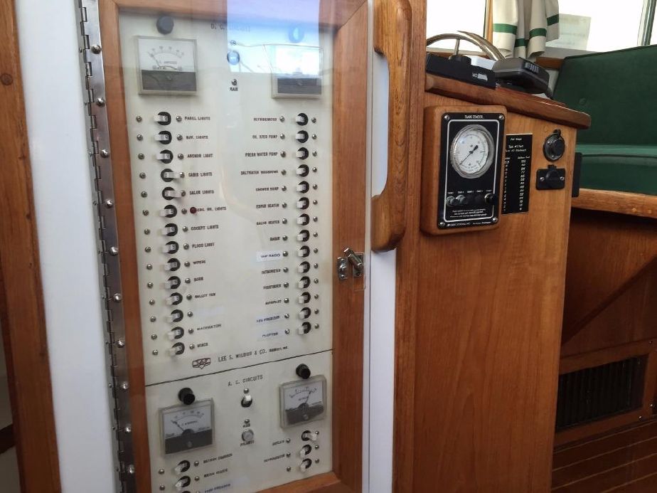

And I have unused breakers on my circuit board, connected to house batteries.
JimP
"The WILBUR" breaker board.
