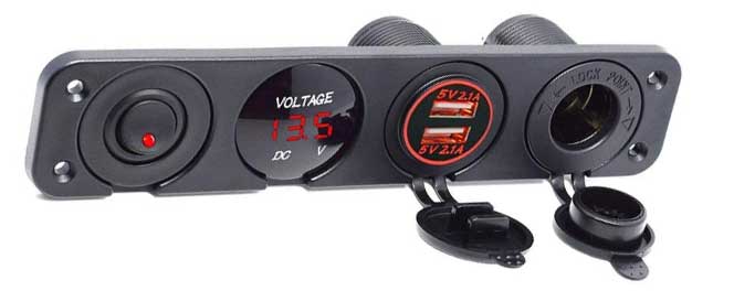

Maybe try something like this that has battery voltage and on/off button.
MASO 4 Hole Toggle Switch Panel with Dual USB Socket Charger 2.1A&2.1A + LED Voltmeter + 12V Power Outlet + ON-OFF Toggle Switch 4 in 1 Multi-function Panel for Marine Car Boat Trailer Motorhome(Red)

Simon--that is a great set-up for my camper.

Simon--that would work for me. I want a three-position switch, two USB outlets, and a Voltmeter. I don't need the cigar lighter outlet. And I don't have a lot of space.

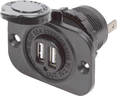

The simplest solution is often the best: get a USB outlet designed for marine use. For example, a BLUE SEA SYSTEMS USB outlet. For example, a 12/24V Model 1016 Dual USB 2.1A Charger
Fig. 1. BLUE SEA SYSTEMS USB Outlet, model 1016.
The Model 1016 has an MSRP of about $31 and often sells for around $22 from discounting retailers.
If you want a voltmeter, SEADOG has a model 456217-1 dual USB with Voltmeter (that measures the input voltage, not the USB voltage) that sells at a discount for about $28. (See DEFENDER.COM for more information.)
As I mentioned, there is a quiescent current drain when voltage conversion is accomplished. In the specifications for their Model 1016 USB outlet, BLUE SEA SYSTEMS notes:
Parasitic Current Draw: 15mA (or 0.015-Ampere)
