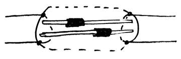

In any case, there is little to be lost from making a splice and seeing how it works. FIrst, I would try to cut out all the chewed areas and make only one splice, if there is enough spare cable length to allow this. As for the technique, I would stagger the location of individual conductor splices, making the total length of the multiple splice connection several inches long. Use heat shrink tubing. Cover with more heat shrink tubing. The most import aspects of using heat shrink tubing is to slide it over one of the wires first, before soldering the splice, and to keep the heat of the solder iron away from the heat shrink so it does not start to shrink in the wrong location.
The most important aspect of the splice is to prevent any obvious shorts circuits or open circuits, and as best as possible to retain the continuity and coverage of the braided shield conductor to cover the splice. Usually the shield can be make larger in diameter, like a Chinese-handcuff, by compressing its length. If the shield is not suitable, you can splice in a larger shield. Again, remember to put this in place first, before you start making splices.

A staggered splice in a multi-conductor cable. If the cable was shielded, restore the enveloping shield.
