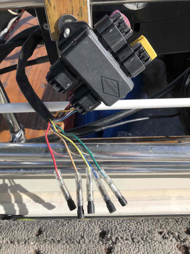

Hello. Certainly this is going backwards technologically given the digital Smartcraft and VesselView options, but how would I go about connecting an analog Mercury tach to my helm wiring? No tachometer at all currently.
I'm assuming either a harness from the purple connector, or a proper connection to two or more of the single pigtails is the solution. Much thanks in advance.
1980 15 Sport side console, 2016 Mercury 60 ELPT
1980 Sport 15 side console - 2016 Mercury 60 ELPT

In the image seen above, I don't see any VIOLET or GRAY conductors. Hence I cannot offer a suggestion that involves the wiring shown.
Re: Analog Tachometer for Smartcraft
Postby jimh » Mon Feb 17, 2020 9:38 am
CactusEd wrote:I'm assuming [the tachometer would be connected to]...a harness from the purple connector...
I doubt that the "purple connector" is a point of attachment for a tachometer. What is shown appears to me to be a network hub. The unused ports are probably capped with a terminator or a weather-seal plug. The reason there is a difference in color of the attached plugs is to differentiate them; some are just weather caps and some are terminators. Only other Smartcraft devices would be connected to the ports on the network hub.
Consult an OEM rigging guide for advice.
First off, thanks for the reference to the wire coding (although it appears that Mercury may or may not have followed that convention). There is a Smartcraft harness past number (Analog Gauge Harness 84-892990T01) that appears to link from the purple 14 pin connector to an array of single terminals labeled for tach, trim, oil pressure, etc. There is also a Mercury "Analog Gauge Interface", and I have seen mentions of having to re-flash the engine's ECU to enable signals to be passed to traditional instruments. Solid information on the whole process is in short supply.

Based on browsing some on-line sellers, the component you are showing in your illustration above is a
Mercury-Mercruiser 878492K14 Smartcraft 4-way Junction Box
The component you have referred to as "the purple connector" is not a connector. It is a weather cap. The purpose of the weather cap is to create a weather seal for the connector into which the weather cap is inserted. The weather cap is identified by its violet color marking. Two weather caps are usually provided in the 4-way junction box OEM part packaging.
The four ports of the 4-way junction box are all equivalent ports. The presence of the weather cap indicates the port associated with the weather cap is not in use.
The device shown in your illustration that connects to a port on the 4-way junction box with a yellow marking is a Mercury 859318T1 TERMINATOR. The purpose of a terminator is to provide the proper resistive termination to the data network backbone at an end of the network backbone.
The use of distinctive colors to identify the weather cap and the network terminator components is to aid in visual identification of those components for the network installer.
The cable from the engine connects to one port of the 4-way junction box. Due to the orientation of the junction box in the image, the color identification marking of one device plugged into one port cannot be seen. That port has either a weather cap or a terminator attached, as indicate by either a violet (weather cap) or yellow (terminator) color identification marking. My guess: it is another weather cap. The other terminator would be at the far end of the network in the engine.
