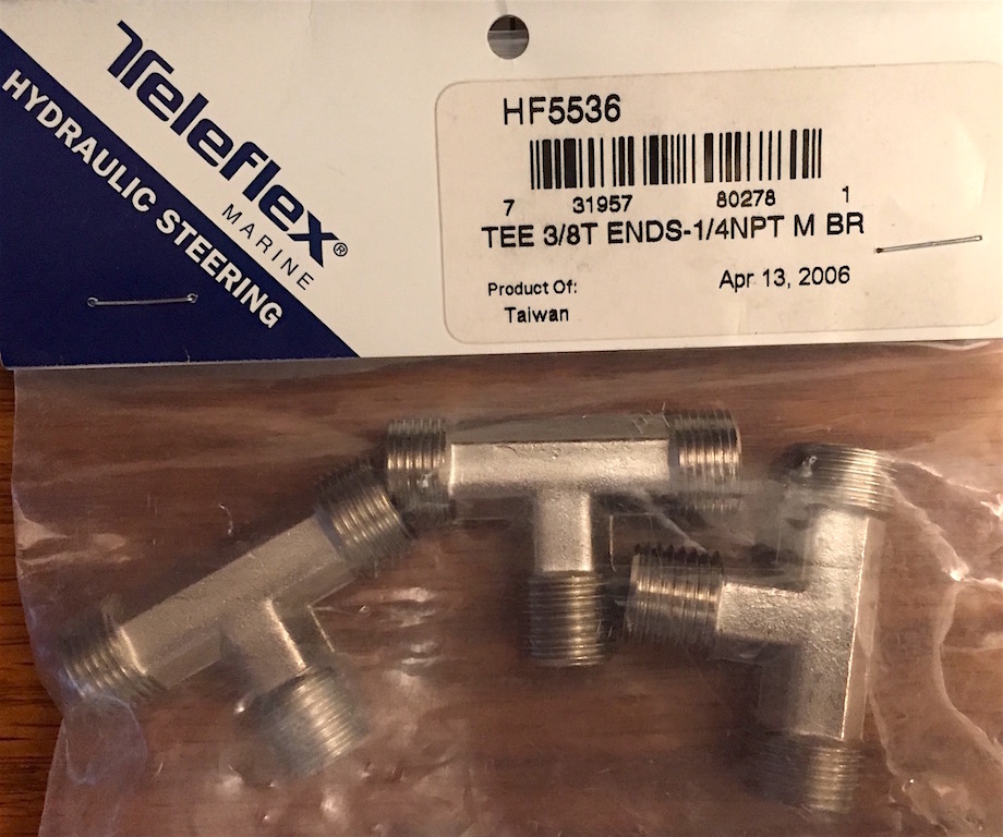

For those following along, the necessary hydraulic fittings were about $22 from [an on-line seller].
TELEFLEX / SEASTAR MARINE HF5536 Hydraulic Steering Tee 3/8" T Ends - 1/4" NPT
