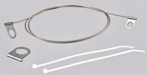

Postby brill » Sun Mar 27, 2016 9:27 am
Oldslowandugly
Posts: 719
Location: Queens NY
Re: Stainless ring terminal
Postby Oldslowandugly » Sun Mar 27, 2016 11:56 am
